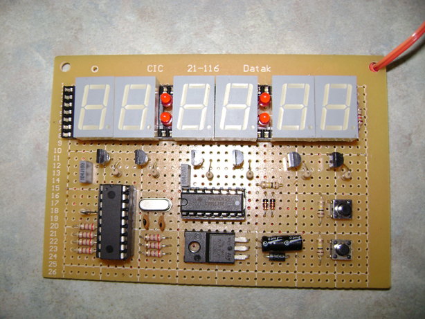

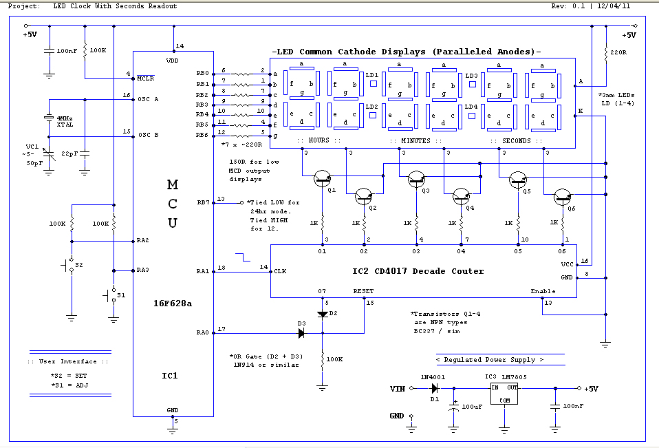

You know you don't need the DS1307 RTC to make an accurate clock.
You can do it all with the PIC and interrupts.... Accuracy better than +/- 1 second p/day
 * PROJECT:
                      < LED 6-digit 24 / 12hr Clock >
              Copyright ©2011 Trent Jackson all rights reserved
 * MCU:
              PIC16F628a @4MHz
 * Compiler:
              mikro PRO C ...
 * Revision:
              0.1b (conforms to hardware revision 0.1b and above)
 * Status:
              Working & complete
   Compiler Messages:
   Available RAM: 208 [bytes], Available ROM: 2048 [bytes]
   Used RAM (bytes): 25 (12%)  Free RAM (bytes): 183 (88%)
   Used ROM (program words): 660 (32%)  Free ROM (program words): 1388 (68%)
   Project Linked Successfully clock.mcppi
   Linked in 657 ms
   Project 'clock.mcppi' completed: 2032 ms
   Finished successfully: 12 Apr 2011, 12:18:55 clock.mcppi

// User-defined 12 or 24hr mode operation ...
#define mode PORTB.F7
// Control lines to 4017 decade counter for display multiplexing
#define mclr PORTA.F0
#define clkc PORTA.F1
// Switch lines (set / inc switches for time adjustment) ...
#define cSet PORTA.F2
#define cInc PORTA.F3

Here is my prototype on veroboard and schematic below...
clk1-jpg.91834
clkschematic-jpg.91835
