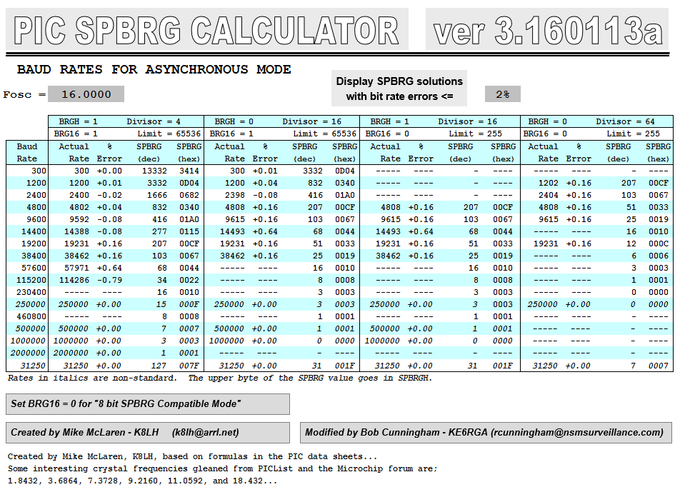

Since most of what I do uses asynchronous serial communications I ensure I have a crystal oscillator available. I've attempted to use the internal oscillator for this and have ended up with frame errors while doing so. This was at 31.25Kbps bit rate, <TXSTA:BRGH> = 1, SPBRG = 31, BAUDCON:BRG16 = 0. SPBRG value of 31 was derived from -
((Fosc / Baud) / 16) - 1 where:
Fosc = 16MHz
Baud = 31.25Kbps
Fosc = 16MHz
Baud = 31.25Kbps

You really should not have had a problem using INTOSC with that Fosc and baud rate (0% bit rate error ±1% INTOSC)...

Different PICs have different internal oscillators. They all have different tolerances. New PICs tend to have better internal oscillators, which are good enough for UART (often much better than this). There's no reason to use old PICs.
This was with a PIC16F628A. I needed the I/O, hence I attempted to use the internal oscillator. Once I encountered those issues, I redesigned it around the 16F886. Since I now had more I/O than I needed, and remembering the aforementioned issues I had using the internal OSC, I designed in an external crystal.
