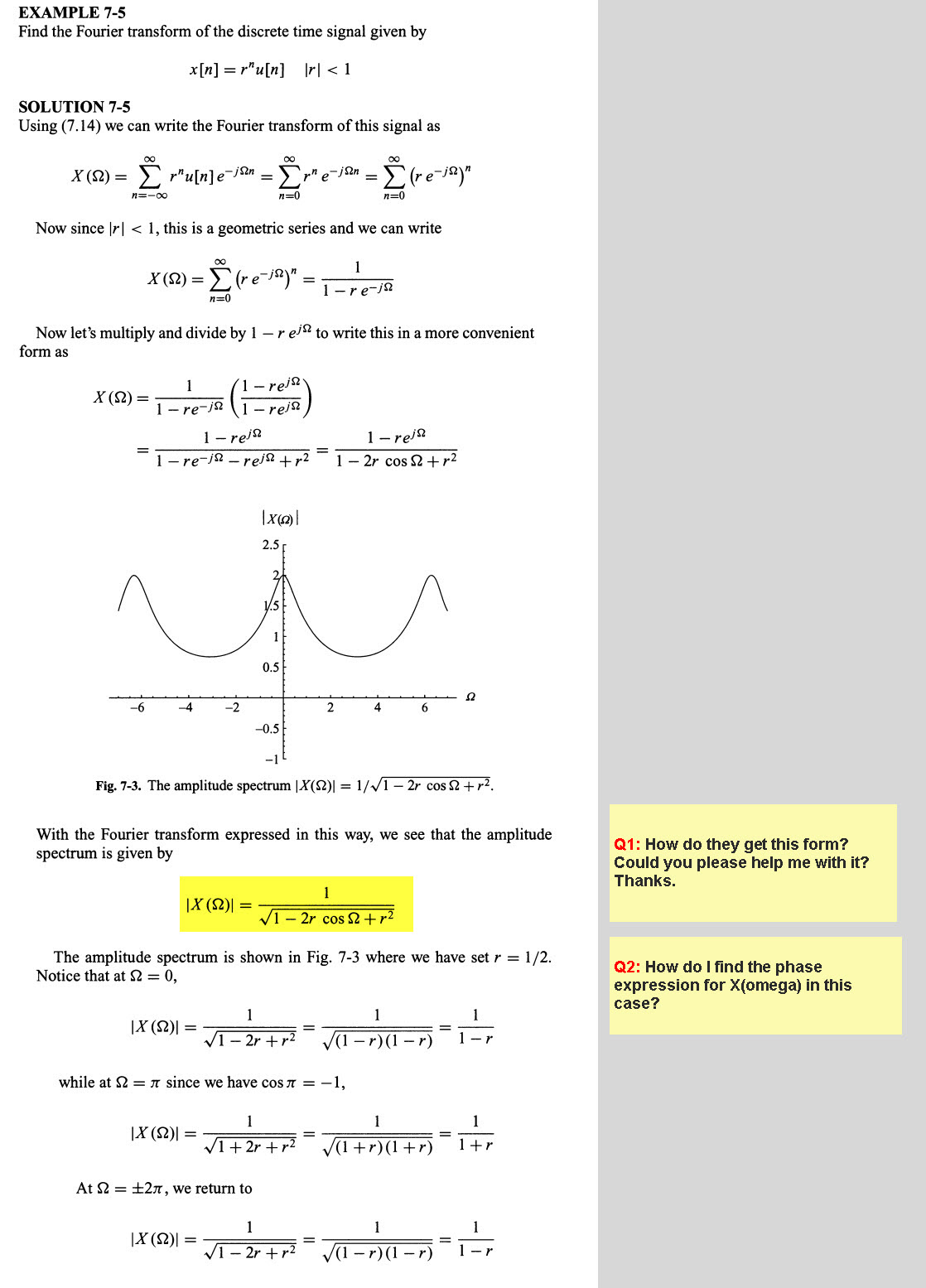

Hi
Could you please help me with these queries? Thanks a lot.

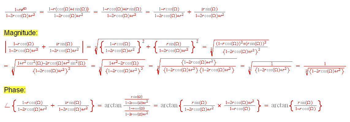

Q1: You just work out the math, and that's what falls out. Maybe you are having trouble starting it off. To start finding the magnitude of a quotient, remember the rule that the magnitude of a quotient equals the magnitude of the numerator divided by the magnitude of the denominator. In this case the denominator is a real number, so finding the magnitude is easy. The numerator has to be worked out and an obvious trig identity will be needed.
Q2: Again, I'm surprised you don't know how to find the phase (or angle) of a complex number.
Lol, good work PG? :)
I was confident you already know how to do this. The pressure of exam time and lack of sleep can make us all think less clearly.
