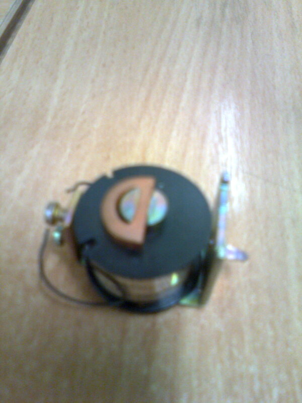

I have this coil from a 230v AC octal industrial relay, actually I've a boxfull.
What is the purpose of the copper D shape piece on the pole, the bit where the relay armature would come to rest, looks like a shorted turn.
I suspect it improves effeciency by reducing eddys or similar (the core is solid not laminated), dc relays dont have these.
I was thinking maybe a circular arrangement of these might make a generator, would I be better keeping the copper piece or losing it.

DC relays do have these and it is to dampen the flux resulting in slow to operate & slow to release relays. They are (were) very common in telephone exchange switching relay sets
Cancel that , I just had a closer look at the pic. But I would still venture to say that it is some sort of flux conditioning.
It creates a phase shift, similar to how shaded pole motors work as mentioned earlier Dr P, in the AC magnetic field so the relay is less likely to buzz and chatter.
As the main part of the core magnetic field passes through zero the magnetic field in the shaded part is lagging behind just enough to keep the relay plunger, or what ever version yours uses, in place until the main part has had a chance for its field to reverse and start holding the plunger until the next half of the AC cycle starts again.

of the copper is passing through the inner side of core (below the coil), then it is perhaps to prevent armature chattering to the 60Nz or so frequency. In later case , i humbly feel that the copper foil forms a sort of shorted winding inside to create a level of sluggishness , that we used to call , slow to operate , or slow to release.
I would request the make and model number of the relay and makersname, to help further analysis, please !!
Picture 005.jpgThe copper tag is just at the edge, it isnt a physical gap adjustment, more a shorted turn.
From earlier replies I summise that it does a similar job as the shunts do in a shaded pole motor and creates a lag in the magnetic flux, and as I understand it this smooths out the pull on the armature.

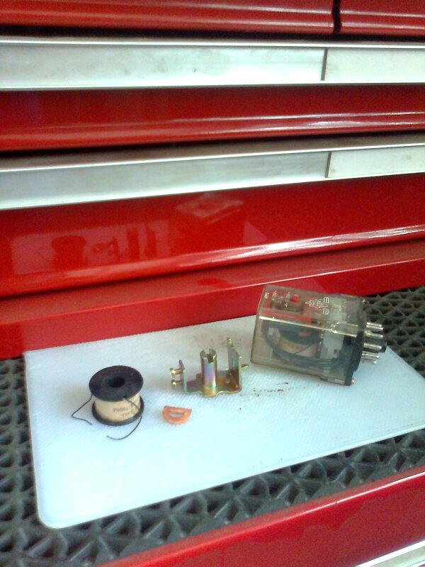

Theres no manufacturer on these relays, however from the equipment I'd say it was made by teledyne in the late 70's, its a plasma treament machine for paper and board, well was its now been scrapped.
Heres a better pic for those interested, theres also a full relay as well as another coil with copper 'D' and core removed.

I think we've covered pretty much all I need to know, esp as I'm going to hack the relay for its winding.
Having read that I might try the shunt on the inboard or as they refer to the heel end of the core and see if that makes a difference, according to the thread on the link it speeds up the response of the relay.

Yes I think I've established that it quietens the relay.
Seeing as I was thinking of making a humble little dynamo to generate a few ma at 6v I dont think I'll be needing the little piece of copper.

it changes the hysteresis loop to being nearly square so that as the magnetic field reverses, it reverses so fast that the momentum of the coil holds it in place, if you cut it or lose it, there is a good chance your relay will start to buzz,
kinarfi
http://hyperphysics.phy-astr.gsu.edu/hbase/solids/hyst.html#c1
EDIT: PS this is practical experience from working with various relays, the stronger the return spring, the more likely to get a buzzing relay, not having the hysteresis ring is not a guarantee of a buzzing relay.
Just to introduce a little theory here. If the copper ring does represent a shorted turn, then it could introduce a delay.
If we could have a perfect transformer with a coupling factor of exactly 1 and zero ohm windings and we energized the primary with a source and then removed the source and shorted out one of the windings (even just a one turn winding), it would take forever for the magnetic field to collapse. Since a perfect coupling is not possible and certainly not how this relay is made, we'll see just a delay while the field is collapsing. The reasons for this is in the definition of the inductor where the voltage across the inductor plays a huge role in how fast the energy stored in the field decreases. With 2v across a winding if it takes 2 seconds to decrease to some small level, then with only 1v across that winding it would take 4 seconds to decrease. With 0.5v it would take 8 seconds, and so on. When we get to zero volts (a shorted turn of a perfect zero ohm winding) the time delay is infinite.
So the net effect in the real life coil is a filtering effect or a delay effect. So that could be the main purpose of the copper.
