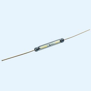

Reed switch - Wikipedia, the free encyclopedia
the smallest available is 1.4x5.4mm, max current 10mA, function: closing. For more info check out MEDER, Germany.
