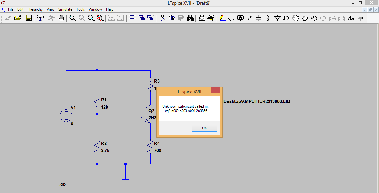

Can someone tell me how to fix this? I'm trying to add a new component
Anyone can help me?

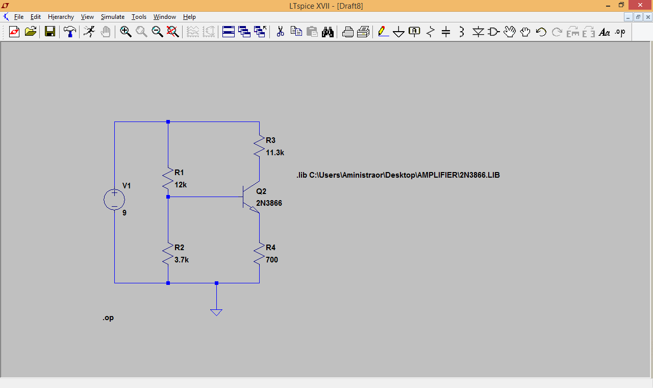

Is that the exact location for the 2N3866 model?
You can also paste the model parameters directly into the C:\Program Files\LTC\LTspiceXVII\lib\cmp\standard.bjt file
A minor point, check the spelling of Administrator, used on your circuit.
