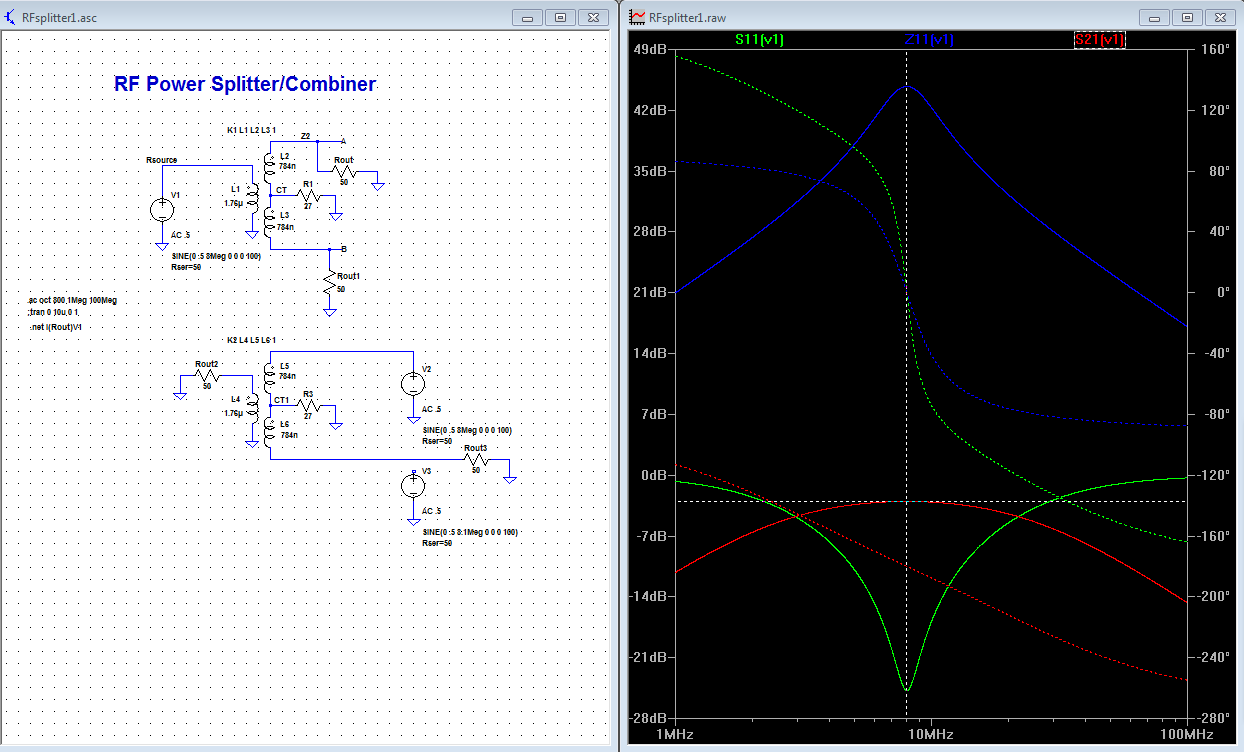

The more I play with LTSpice the more I love it, it is very powerful indeed. I recently discovered (By reading the included manual), that you can do S-parameters, which is fantastic :)
I built a RF power splitter/combiner and been comparing actual test results to simulations, and boy they sure come close. I want to do a little write up later after I compile all my test results and put it down on paper. Oh by compare, I mean transient analysis not the S-params as I do not have equip for that. But here is a shot using the s params.

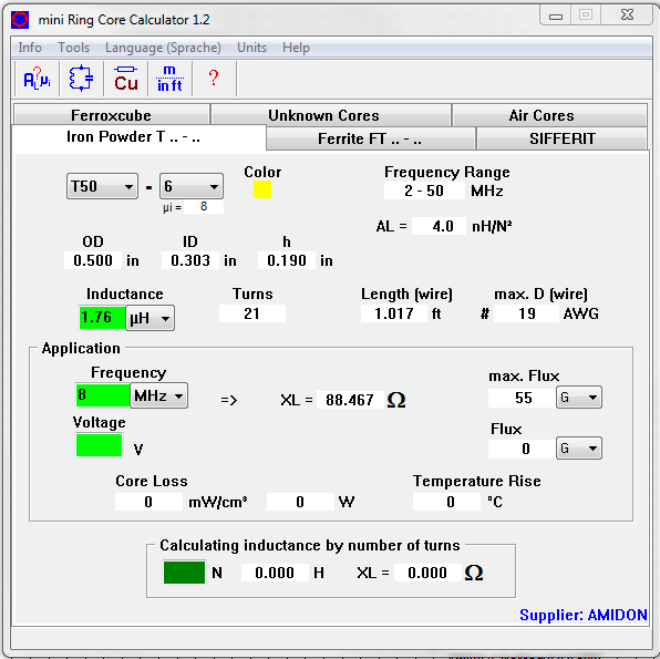

Yeah, when I was setting up my design I tried to get as much of that data as I could. I used a program from Amidon (see image) which helps calculate the parasitics. I used a T50-6 iron powder core, so I used the values provided in the program. I tested my resonant point using a sig gen and 50Ω resistor and swept for a peak. I am included a page from my notebook.
