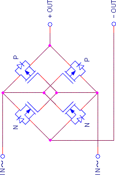

Can't get this to work and about to bang my head against the wall.
The two FET's at the bottom are creating a short, yet it's exactly as per the image and I've had it working before.
(replace the fets with anything you like just to make it work or use the included lib).

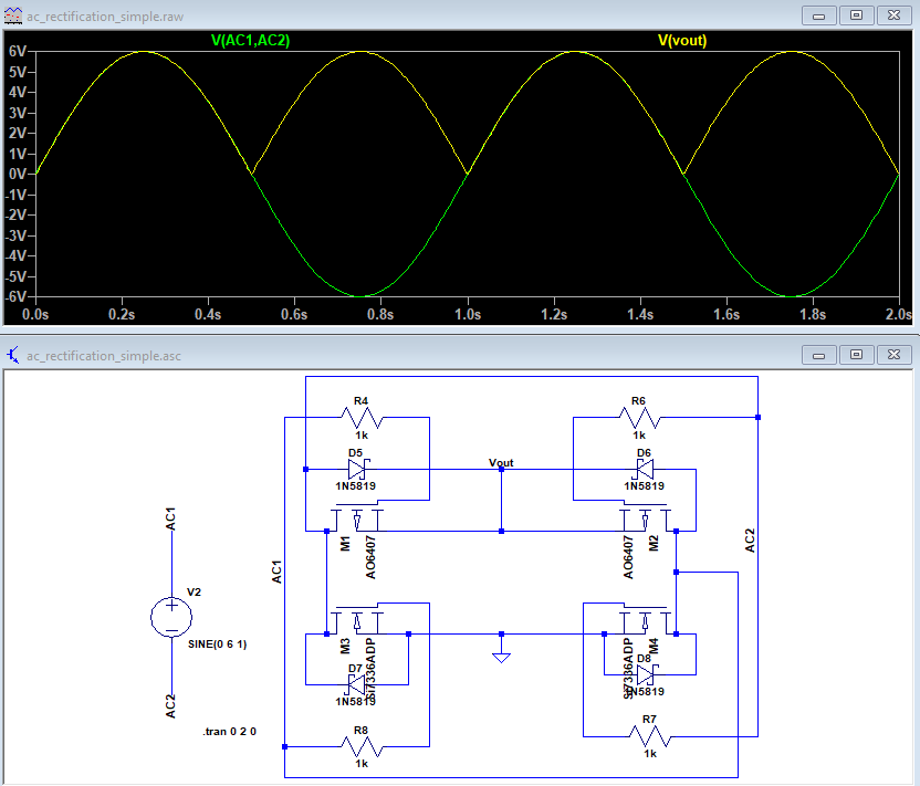

Yes, it doesn't work because that half of the bridge will always be shorted. Each NMOS device will be shorted through the other (flyback?) diode. Look at the current through each section of that half-bridge.
This could probably be rearranged to work, but I'm not up to troubleshooting it atm.

Okay, I see what's going on. This is a dual N+P device. You specified the same subckt name for both parts, and both appear to be behaving as PMOS devices.
IDK how you can refer to two identically named subckts from one lib file. There's probably a way.
I just edited the lib file such that the NMOS and PMOS subckts had unique names, and then used those unique names in the simulation.
Looks okay to me with different MOSFETs.
The problem is as DGM noted.
