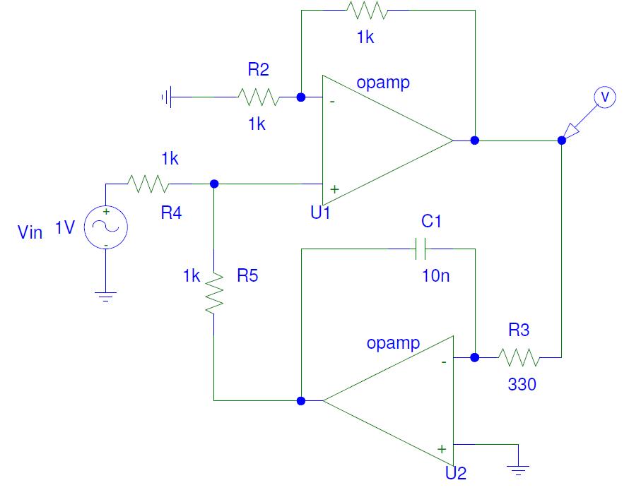

What is the best way to create a LOW NOISE differentiator? I am using it for a controller.
One Idea I came up with was to use a negative feedback integrator to differentiate, but the transfer function still remains the same as a regular differentiator. I was wondering what were the effects of this?
The System transfer function is
SRC/SRC+1 Where R and C correspond to the integrators components.
for those of you who dont know, the top amplifier is a summing amplifier and the bottom one is the integrator.

Don't know that the circuit you show has any particular advantage over a standard differentiator.
A pure differentiator tends to be noisy because it's gain continues to increase with frequency (within the op amps gain-bandwidth), so you get a lot of high frequency noise. You can minimize this by rolling off the frequency response above the frequencies of interest for your application. In a standard op amp differentiator circuit this can be a resistor in series with the input capacitor and a capacitor across the feedback resistor (if each has the same RC time-constant, then the gain will roll off 6dB/octave above the rolloff point).

i think it is a summer, my PSPICE models agree with me.
According to my simulation, your circuit is a differentiator up to a corner frequency of about 49kHz. Above that the gain is constant at 1 (0dB). Below the corner frequency the gain drops at 6dB/octave. For example at 1Hz the gain is about -94dB (likely the noise level of the circuit). For more gain you can increase the feedback resistor of the top op amp, but that also changes the corner frequency.
I see no advantage to your circuit over that of a single op amp differentiator circuit with a resistor in series with the input capacitor to give a high frequency rolloff at the same corner frequency (which is standard practice with a differentiator).

Wrong:
Vf =- Vout*(1/RSC)
Vout = Vin - Vout(1/RSC)
Vout (1 + 1/RSC) = Vin
Vout = Vin /(1+1/RSC)
multiply numerator and denominator by RSC
Vout = Vin RSC/(RSC+1)

Attached is the Bode plot of the Op's circuit. It has a rising gain and a 90 phase shift until the corner frequency, thus showing it has a standard differentiator output until the corner.
yup, I knew that and said that by the S diagram. Is there a way to make a cleaner differenciator. I understand that it boosts high frequency noise, but would that be only from the input? Is there any benefit of using the integrator configuration of an op amp instead of differenciator.
Yes, for most applications the noise is primarily high frequency noise from the input, not the op amp. So using the integrator configuration would have no effect on that. The integrator configuration actually has two op amps in the loop instead of one, so the op amp contributed noise would likely be higher.
