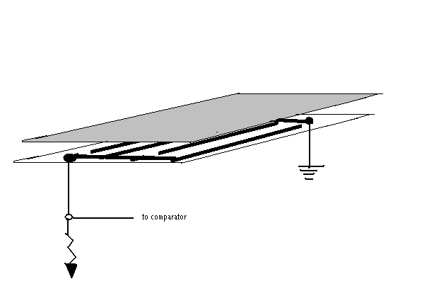

Also, another idea is to used the rubber from Trucks/Cars tires inner tubes (there are very few since most tires don't used it any longer) anyway... the rubber acts as a variable resistor under preasure. You need to make a interlock pcb trace and put the rubber over it. The change in resistance is very low but using a comparator set to very low voltage you can detect when it is press.
(you may need do a little sanding on the side of the rubber that will contact the PCB trace).

I was under the impression that the QTC technology was supposed to be more linear then conductive foam or rubber. If not why bother with it?
One of the things I recall is that it was conductive enough to be used directly as a switch without a comparator or A2D conversion.

hi 3V0,
IIUC the black conductive foam changes resistance due the applied pressure due to the compression of the foam,
which forces out the 'air pockets' within the foam.
This increases the total surface contact area within the foam and so the resistance falls.
The foam does dry out and it changes resistivity/sensitivity with time.
I believe there are applications where using black conductive foam would get the job done.
I would doubt if foam has the same current carrying capabilty as QP.
The quantum tunnelling compound is a totally different technology to foam.
