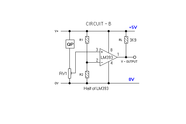

I did a little search and found this diagram on a site:
The graph of circuit-b is exactly what I want to achieve, but where Ref-V is the output of an 18-turn cermet so I can calibrate the tiles to trigger on a very light touch. Some of the more advanced songs in dance games require 2 tiles to be pressed with the feet for a period of time and for a 3rd tile to be pressed with the hand, so getting the calibration right to do this is important for this project.
Unfortunately, I can't read circuits very well, so could you give me some advice about building cuitcuit-b in the above diagram (if you think it would be suitable for the task).

The common comparator I use is the LM393 its a dual device, that will work at +5V.
Datasheet here : www.datasheetarchive.com
Cct B would require a +V going pulse on the input to give +5V on the output.
RV pot circuit is drawn in a 'general' way, it would need to be changed slightly.
The junction of R1 and R2 [ and their values of course] set the +Vref to which the incoming +V pulse is compared.
When the +V input pulse is slighty greater than the Vref the output will goto +5V.
To design the RV would require some measurement of the voltage ranges you would expect from the QP pads.
EDIT: you would need to supply say +5V to the pills, which would have a series resistor connected.
Something like this.
I need to know the voltage outputs [ or resistance value] of the QP when pressed by the range of the forces applied during use.:)

In that case circuit 'A' would be right one to use, leave off the 3K9 on the output.
When the input from the QP inverting input goes high, the output will be connected to 0V, low.
