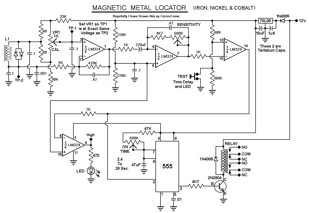

I just Draw My Schematics in an Old Version of "Paint Shop Pro".
You can Zoom in Big, if Needed.
I do All Lines 2 Bit Wide for Good Clarity, They Print and Scan Really Good.
I create my own electronic Symbols, than copy and paste them as needed.
One Example:
