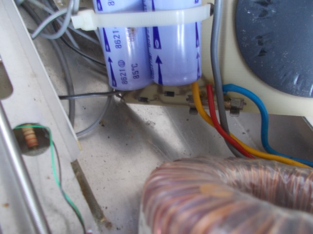

If the unit is completely dead, the implication is that it's most likely a fault in the PSU module.
Last time I switched it on the neon light came on, though not working. I have been learning a little about PSU, full wave rectification, smoothing caps. I know that those PSU caps can pack a punch. So don't really wan't to fiddle about, sticking fingers in here and there...... until I really know what I'm doing.

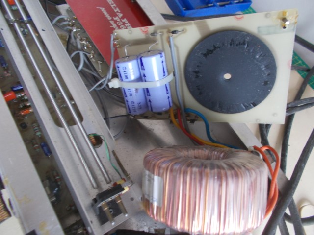

From the photos you posted, it appears to be a simple transformer + rectifier & smoothing capacitors type circuit - not a switched mode type where the capacitors are charged to several hundred volts.

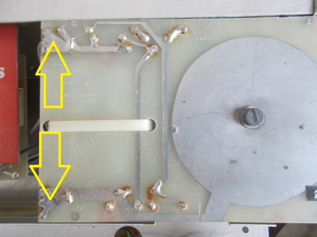

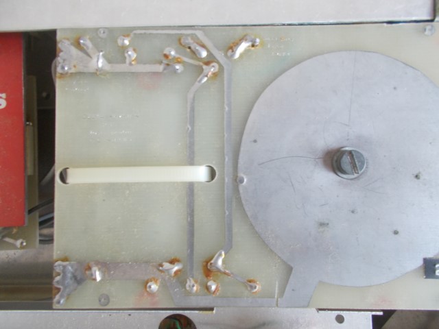

Can you post some more photos of the PSU module, rather closer in, but overall views to see all the PCB tracks and connections?
Yes, it's a basic and simple PSU and amplifier, the power supply will only be about 40V (or 20+20V) - should be easy enough to draw the circuit out and repair it.

Here they are. I could have done the original soldering a bit better, never mind. I tested the fuse, works.

OK, that's about as straightforward as the come.
What voltage do you get across the capacitors; the output terminals at the left of the first photo?

Sorry for delay in replying. The meter read 55V I then thought I should discharge the capacitors. I connected a set of pliers across the same terminals, for volt reading, followed by a spark, loud crack and wisp of smoke. I had safety goggles on and wearing rubber gloves......Checked with meter, no voltage reading. Perhaps I should leave off this until I have learn't quite a bit more about electronics?
You only need to discharge capacitors if they will present a danger. 55 V is low enough to not really be dangerous, but a 80 + volts it getting to where it can be a a safety issue.
It's best to put some resistance in the way when discharging capacitors, but you may not have done any significant damage.
Was the power on when you discharged that capacitors? If so, that was the wrong thing to do and you may have damaged the diodes or a fuse. The transformer will be fine. If you short a transformer of that size, it will take a minute or more to heat up enough to burn out.
What is the voltage rating of the capacitors? What is the output voltage rating of the transformer? The input voltage will match the mains voltage.
