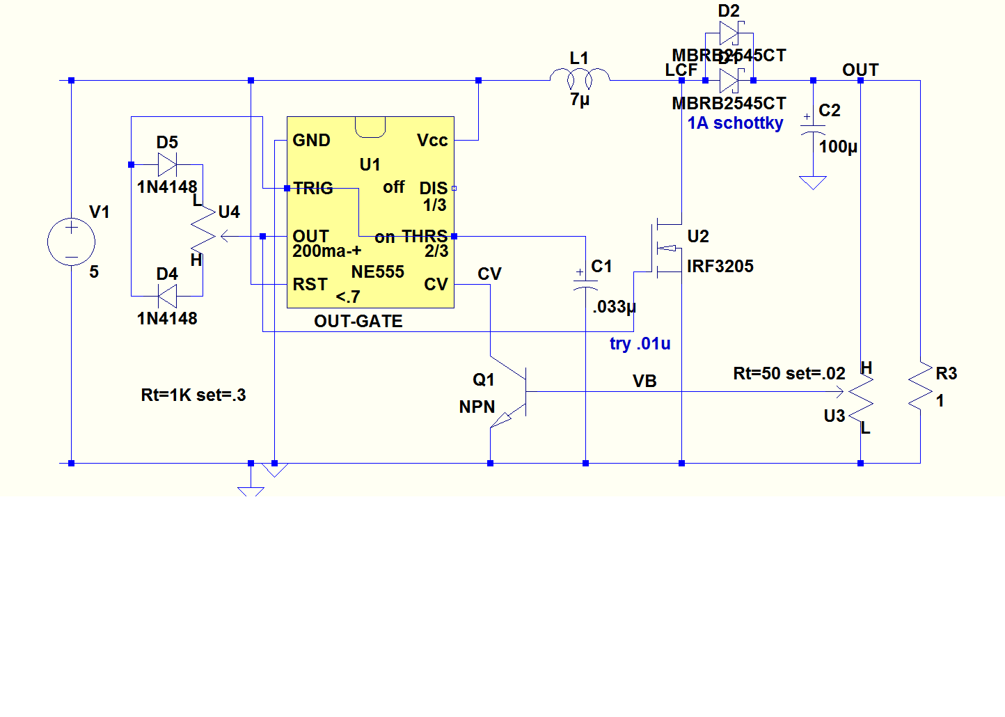

5 TO 12 Mosaic.png I was playing video games(simulating with Spice) and thought about your problem, I don't know how this will work in the real world, but it might if groomed out further, who knows? play with it and see what you can do.

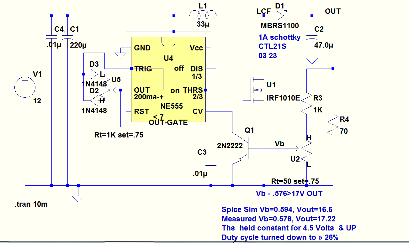

Mosaic,
555 VOLTAGE BOOST35vlite5050.png I assembled this circuit planning to use it to boost 12V to 30V to drived a COB LED at my work bench, I made a mistake and turned it up to 35V and ruined the COB LED. I turned the output down to using the duty cycle adjustment and then turn the output down further using the feedback from Vout and stopped at about 17V. I then turned the input down to 5 V and the output held constant down to ≈ 4.5V. I didn't have much load (100Ω), I didn't work with it much after that, end of the day.
  • 555 VOLTAGE BOOST35vlite5050.asc
I did some more testing of the circuit in post #10
Vin=5.04
Vout=12.17@840ma
Vb=.528
Rl was 12Ω + amp meter and jumper leads
