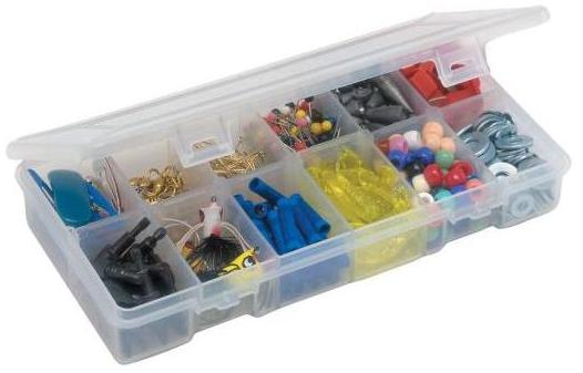

Currently I use something like this:
The box does not seal really tight on the outer edge so the small 1206
component can enter another compartment if not kept horizontal.
Really what I am looking for is a smaller container to fit inside each of the compartments.

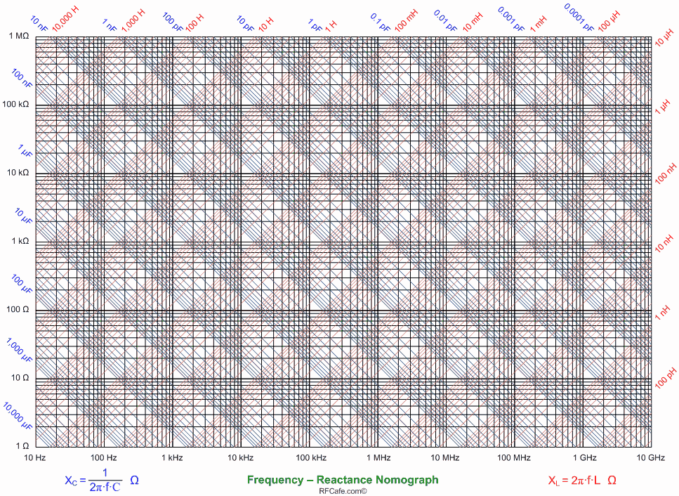

one method i use for measuring capacitance is to put the cap in series with a known inductance and feeding the series circuit with RF from an RF generator. at the resonant frequency the circuit acts like a short, so monitoring with a scope across the series circuit will show a definite dip in amplitude at the resonant frequency. now you have two known values, the inductance and the frequency. C = 1 / (4π2 f2 L) Capacitance [F] is how the capacitance is calculated, but it's much simpler to use the reactance chart:
since one property of resonance is that Xc=Xl, find the line for the known inductance, and where it intersects the resonant frequency, and then look at the capacitance scale for the result. this is one the most useful charts whether you work with audio or RF... i originally saw it in the ARRL handbook, and i keep a copy of it in a notebook along with other charts and miscellaneous information.

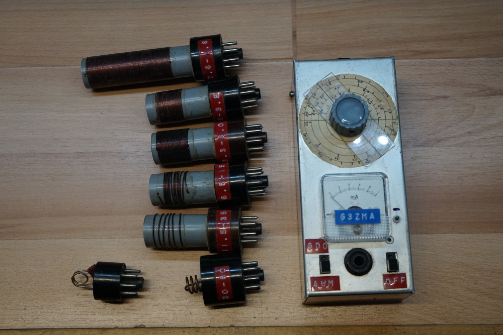

The only thing mine has been used for, for the last 20+ years, is as a base for other boxes of junk to stand on in the attic...
It probably still works; it was a very nice unit for its age even when I got it, 5 - 400 MHz coverage.

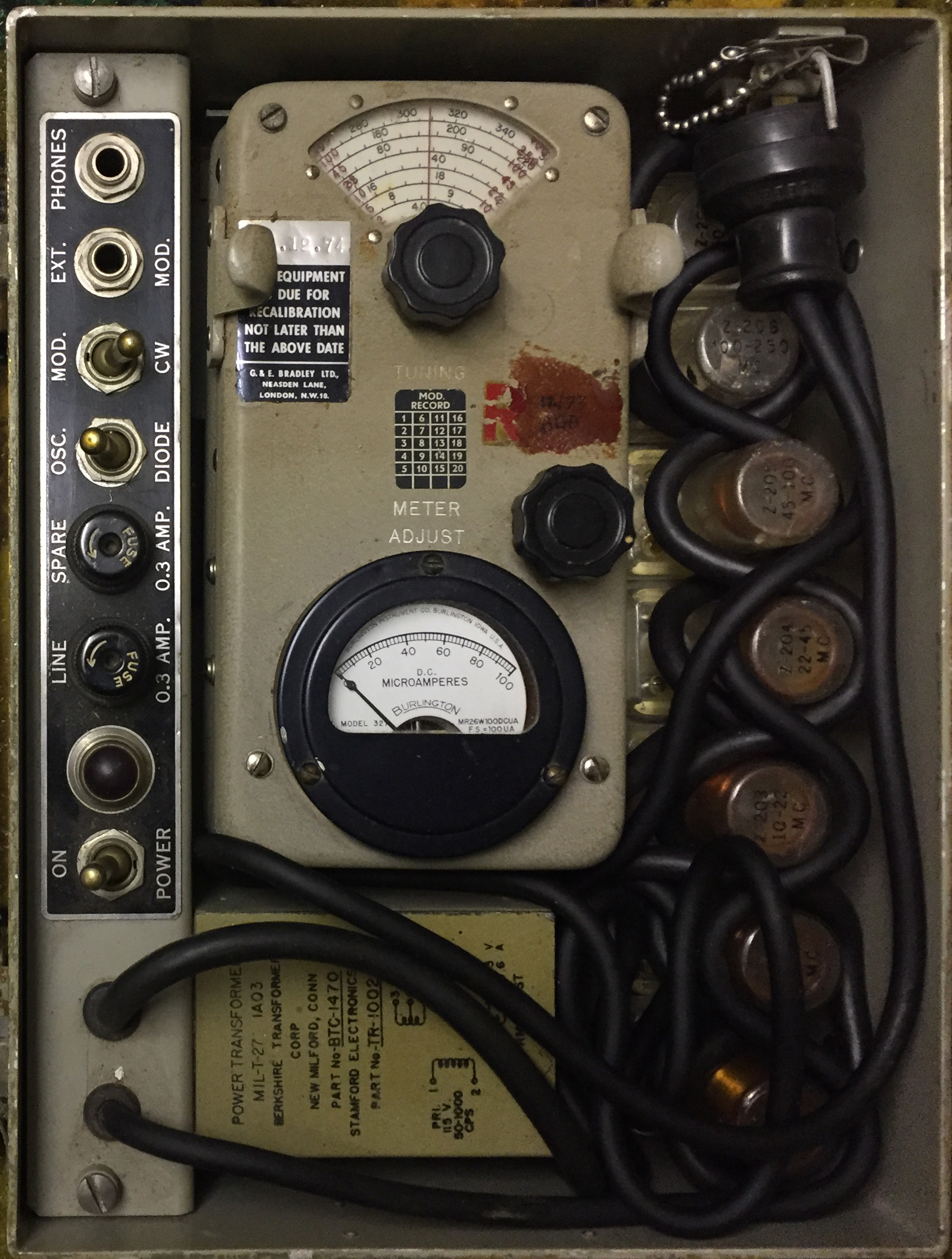

OK, here is mine:
I built it around 1971 and it was very useful for many years.
It is far from perfect, some ranges don't work very well.

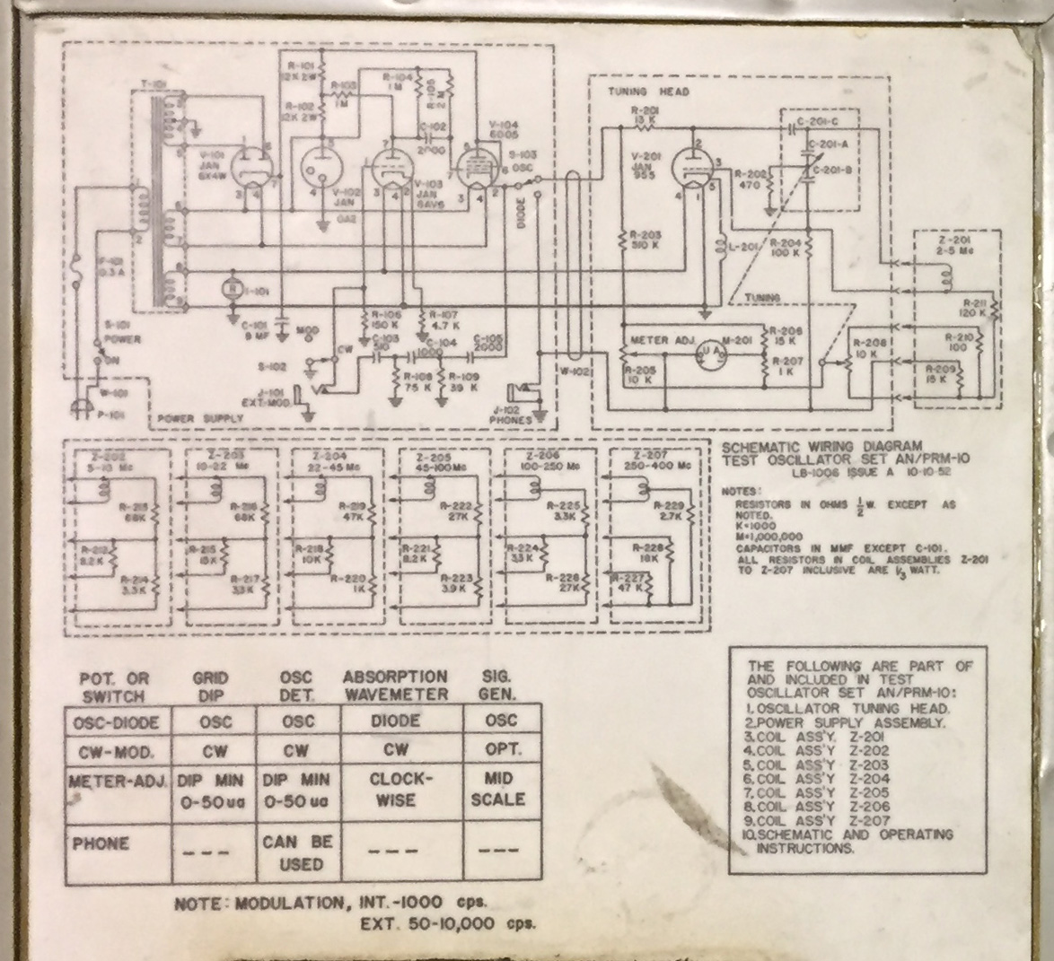

I notice in the schematic posted by rjenkinsgb that there are resistors in the coil units to configure the oscillator for the individual ranges.
