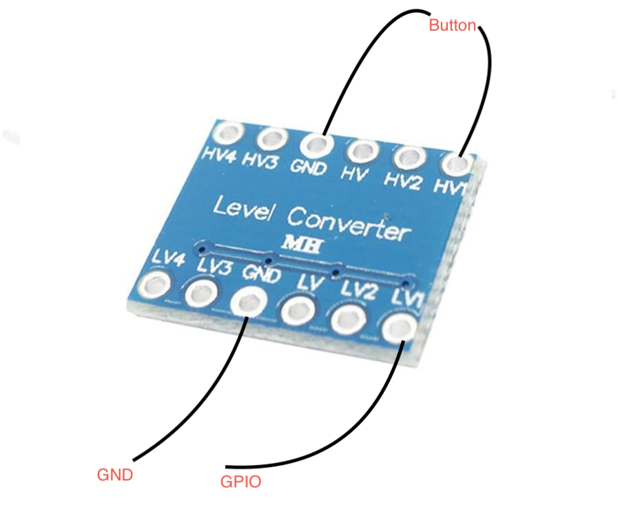

I want to substitute a button on a board with gpio from a nodemcu (3.3V) - the button is wired with 2 wires and uses 5V.
In a nut shell, I want to be able to control the "button pins" with the nodemcu.
I read that the nodemcu might be able to tolerate 5v on the pins - but that is probably not a nice solution.
Can this be done with a Logic Level Shifter (I have a bidirectional LLC with LV,GND and LV1-4 on one side and the same for higher voltage (HV) on the other)?

The official word from Espressif (makers of the ESP8266 used in the Node MCU) is that the digital pins are 5 volt tolerant, so you shouldn't have any problems at all.
Yes, that should work. Those level shifters are usually bi-directional, but you can run them in one direction only if you wish. I use one module to interface a GPS serial (3.3V) to an Arduino (5.0V). Serial really only runs one way, but like you say, why risk having 5V on a device that expects 3.3V, even if they are "5V tolerant"

I would just like to know how I would have to wire it, because I'm interested.
Is my wiring in the attachment false?
I only have two wires from the button...

You have to wire in the LV (3.3V) and the HV (5.0V) as well. It won't work without the voltages and grounds. Grounds can be connected together (usually they are)

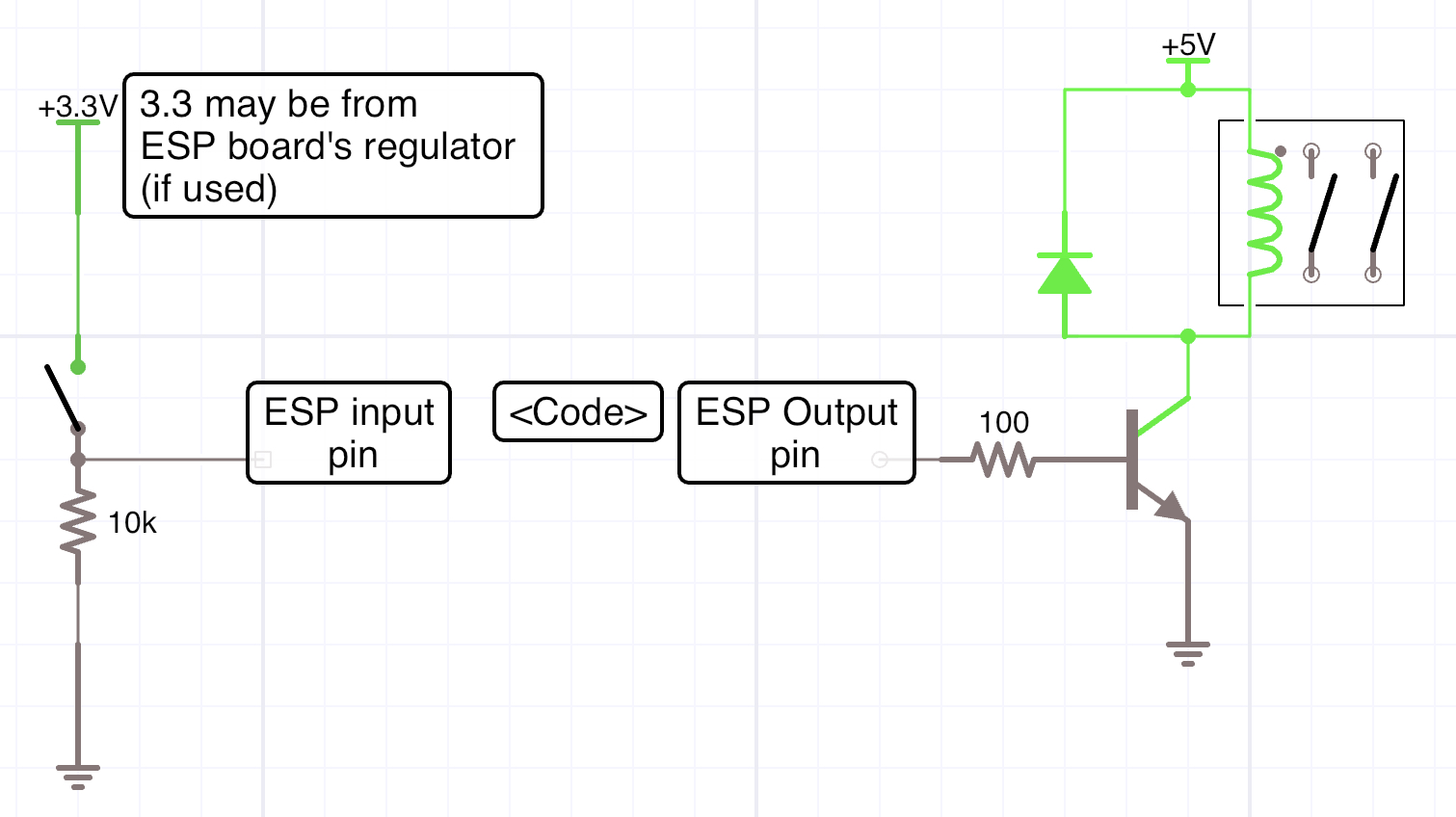

Why can't the button use 3.3V? Button between pin and ground and a pullup resistor to 3.3V.

Since I don't have have a power pin on the board with the button, I will not over complicate it and just use it directly.
I didn't want to use 3v on the button because it controls a relay and I wasn't sure if the relay would trigger with 3v...

If you don't want to put 5v on the esp pin, you can use code to translate the button press to a transistor base to drive your relay.
Make sure there's a transient-suppression diode (e.g. 1N4148) across the relay coil (cathode to positive).
