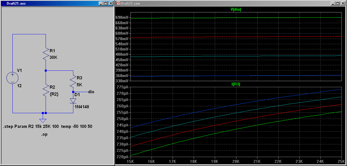

Ok, this is not homework per se. I'm reading a textbook for personal learning. Working through the problems. I have come across this problem I'm having trouble trying to solve.
fig-3-23b2-png.70796
What value should R2 be in the above figure to set up a diode current of 0.25mA?
Can somebody walk me through this?
Thanks!

To start you need to find the voltage required to drive this diode....
i is constant so 5000 * .25mA = 1.25v.
Add the voltage drop of the diode @0.6v = 1.85v
Now you can find out how much current will be running through the 30k resistor
12v - 1.85v = 10.15v
10.15 / 30k = 0.338mA
You need to deduct 0.25mA from this... = 88.33uA.
now work out the last resistor 1.85v / 88.33uA = @ 20k...
Ok. I know that the voltage drop across the diode is 0.7V. So, that explains one discrepancy I had.
So, 5k = 5000 Ohms, .25mA = 0.00025A
5000 Ω * .00025A = 1.25 V
Vd 0.7V + 1.25V = 1.95 V
12 v Total - 1.95 V R3 Leg = 10.05 V
10.05 V / 30000 = 3.35*10^-3 = 3.35^-7
This is where I'm lost. Been out of school too long. Lost in the exponent manipulation.
When I subtract .25mA from this, the values don't make sense to me.
Insight or suggestions anyone?

Without giving you the answer direct, make a Thevenin equivalent circuit using R1 & R2 then work on this equivalent resistance, new voltage and R3 to calculate the current through the diode.

Solved. Thanks for the help everyone.
This is how I solved it.
0.7 V = diode voltage drop
12 Vin
.25mA is known or .00025A
V = I * R so, .00025 * 5000 Ω = 1.25 V
1.25 V + 0.7 V = 1.95 V on the R3 leg
12 V - 1.95 V = 10.05 V on the R1 leg
I=V/R so, 10.05 V / 30000 Ω = 3.35*10^-4
3.35*10^-4-.00025A = 8.5*10^-5
1.95 V / 8.5*10^-5 = 2.294117*10^4
Now putting this into readable form. 22941.17 or rounding it off to the nearest 1000. The answer would be 23 k Ω
Thanks to all those who helped. Much appreciated!
I get 16.5K to 22.7K
look what happens when I asked LTSpice to solve it. The x=axis is the value of R2. Plots show the voltage across the diode, and the current through the diode as a function of R2 and temperature. Green=-50C, red=0C, lt. blue=50C, dk. blue=100C.
Note that the assumption that the voltage across the diode is 0.7V leaves quite a bit to be desired... :eek:
A diode makes a very good temperature sensor...

For the purposes of the textbook this was a solve it on paper with calculator exercise. So far the text only mentions a voltage range of 0.6V - 0.7V (voltage drop). So, that is what I had to work with.
I find the LTSpice method interesting. Handy to know the temperature variations and their effect on the circuit. Had no idea that you'd get that range of answers.
