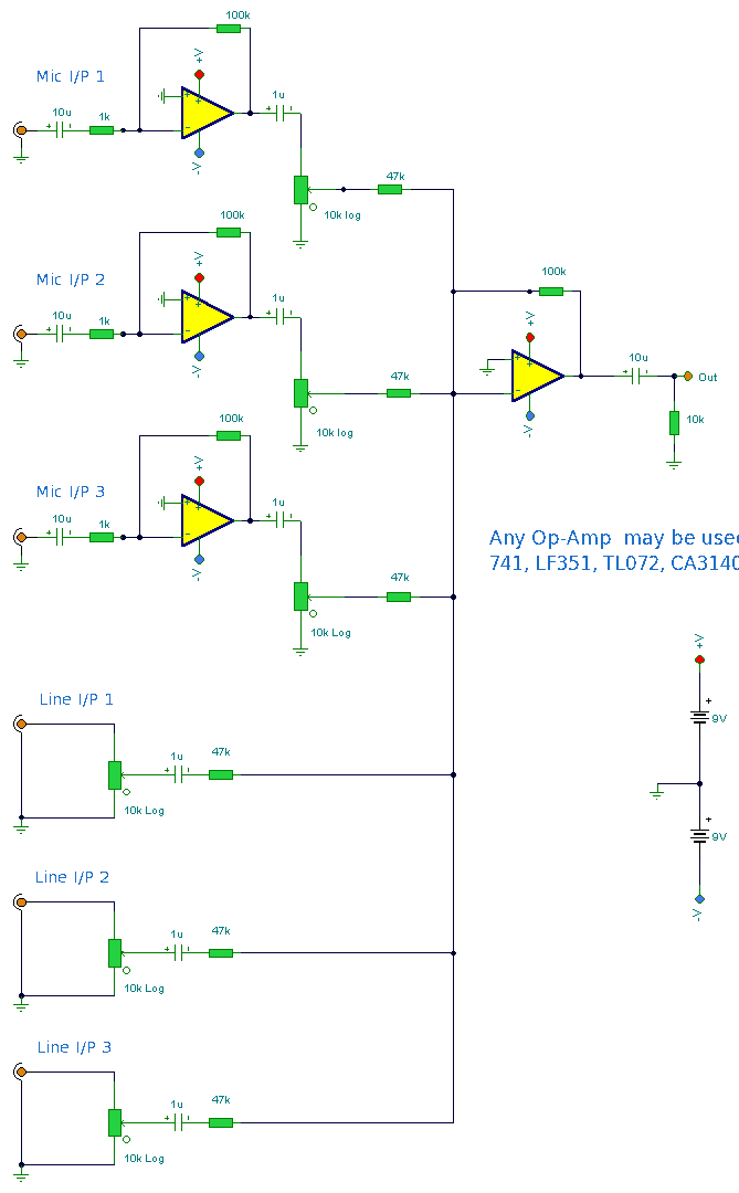

ok- lowering the voltage is easy. making it bigger was the problem. is this preamp circuit any good? I want to modify it so it is 2 mic inputs, 2 normal inputs. The normal inputs will be mixed with a single, dual gang pot because it is in stereo. Feed that then to my LM4766 and I should be right, right?

Your preamp/mixer circuit is fine. But don't use lousy, noisy, narrowband old 741 opamps. Some of the other opamps you listed are also bad for audio.
Use TL072, TL074, OPA2134, OPA4134 opamps. National Semi have a new dual opamp, their LM4562 dual that has a distortion of only 0.00003% even with a 600 ohms load.
