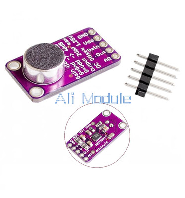

You can get some small mic modules that have a preamp with AGC included. I don't know if they could help to get better gain and level control? Add again preset between that and the LM686.
Search "Adafruit MAX9814".
Example:
