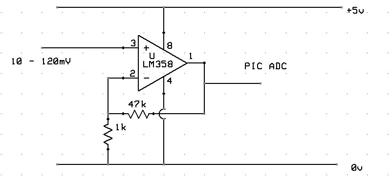

Hi Guys,
I have been experimenting with a very simple Op-Amp amplifier, based on the LM358. I would like to amplify a small DC signal ranging from about 10mV to approximately 70mV, with a gain of about 48, to be fed into a PIC's ADC. However in doing so I have found that the gain of the amplifier setup changes depending on the input voltage, the gain is not constant.
In an attempt to rectify my problem I have tried lowering the gain, adding supply capacitors and changing the Op-Amp chips, however all of this leaves me with the same problem.
So my question is, is it possible to make the gain nice and constant? Preferably without having to drastically change the setup, or if so, keeping it nice and simple. I have also attached a copy of the circuit I have been using.
Thanks in advance, :)
Tom

With a +5V single supply to a LM358, the maximum output voltage will be ~ 5V-1.5V , ie: 3.5V
Also the output of the LM358 will not go down to zero.
With a gain of 48 [ as shown] the 10mV offset at the input will appear at the output of the LM358 as 0.48V, so you circuit also needs a correcting offset to remove the 0.48Vout
If you used a 8V supply to the LM358, you could get the required +5V output.
A better solution would be a rail to rail OPA, like a MCP6002 [dual], powered from +5V, the outputs would swing 'close' to +5V and 0V.

The gain varies from about 46, at 10mV, to 51, at about 60mV. At first I thought that it was insignificant, but when I re-did my maths it threw the PIC's reading out to a value that was unacceptable.

For an OPA , the gain should not vary by that amount, 46,51.. There is another problem or perhaps the way you are measuring the input/output voltages.

All opamps have noise and the LM358 has more noise than better opamps. The noise is amplified and appears at the output.
All opamps have an input offset voltage. It is a maximum of plus or minus 7mV for the LM358 and is almost nothing on better opamps. The input offset voltage adds or subtracts from the input before amplification. Single opamps have pins to connect an offset voltage null trimpot.

Hi again,
As i said before, the LM358 op amp is a general purpose op amp and not really made for instrumentation type applications unless it is driven within certain limits and other details that have to be taken care of.
The problem you are seeing is probably due to the input offset voltage of the op amp. The input offset voltage acts to add or subtract up to 3mv from the input, but its effect would show up as non linearity (as you are seeing).
For example, say we have +2mv input offset and a gain of 50. For 10mv and 50mv inputs we get:
10mv: 10+2=12, 12*50=0600, 0600/10=gain of 60
50mv: 50+2=52, 52*50=2600, 2600/50=gain of 52
The above was with an input offset of +2mv, but it very well could be -2mv instead, but the effect shows up as the appearance of a change in gain. There are ways to help correct this to some degree.
This effect shows up more for low inputs like 10mv, but diminishes greatly as the input increases. For an input of say 100mv the effect on the gain would only be about 2 percent.
If you know the precise values of the resistors you can easily solve for the input offset voltage, but if not or there is some doubt you can use this:
Vio=(Vin1*Vout2-Vin2*Vout1)/(Vout1-Vout2)

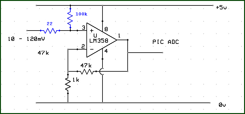

Hi again,
Taking the input offset voltage into account the way it is now and because your input change is quite small, there's a trick we can incorporate that might work for your setup. (See attachment).
It looks like your Vio is negative, so you can try this...
Add a 22 ohm resistor in series with the non inverting terminal of the op amp. Your input voltage now connects to the open end of the 22 ohm resistor, not the op amp terminal.
Add a 100k ohm resistor from the +5v rail to the non inverting terminal of the op amp.
Recheck your gain for inputs of 10mv and 60mv.
The value of the 22 ohm resistor is somewhat arbitrary, and the 100k is approximate so you may have to tweek the 100k a little.
This assumes that your +5v rail does not change too much either, that it is regulated quite well.
If your input offset turns out to be positive, we would have to do something else, but it does look negative right now.
This also assumes that your driving source can drive 100k ohms without any problem. If it cant then you'll have to scale the 22 ohm and 100k up, possibly as high as 220 ohm and 1megohm.
If you change the positive supply rail you have to change the 100k resistor. For every 1v increase, increase the 100k by 20k...so for a 6v rail use 120k.
Im not sure what kind of accuracy you are after there either. You should do a temperature check to make sure the gain doesnt vary too much when the temperature varies over the expected range. This is true for any circuit you use.
One final note, if you swap out the op amp with a different physical package you may have to change one of the resistors (like the 22 ohm) because the input offset could very well be a different value for the new package even though it's the same part number. The values given above were for the op amp package you used when you posted your test results with the 10mv and 60mv inputs.

I am not sure how it works, it is modifying the gain on the op-amp or is it adding a positive offset voltage to null the negative offset?
If it was positively offset, would it work by connecting the +5v side of the 100k resistor to ground work?

If you connect the 100k resistor to ground then you will not cancel your input offset voltage.

As audioguru points out, the connection to +5v is so that we can get a small positive voltage at the input to the op amp which hopefully cancels the negative offset. It's designed to be close to +1.1mv which is just the opposite polarity of what we thing is your negative offset for the op amp. If the 100k is connected to ground it wont be applying any positive canceling voltage so it wont work as well.
It does not change the gain very much because the 22 is so very much smaller than the 100k, and it is possible that the gain is already very slightly higher than you want it to be possibly due to imperfect resistors, so you may have to adjust the gain slightly, but that's an independent adjustment to the offset null. I dont know what kind of accuracy you are looking for here though, perhaps i should have asked more directly so we can get an idea what you are after.

I have tried Mr Al's resistor network and it works quite well the gain varies from about 47.8 to 49.2. So it is much better.
