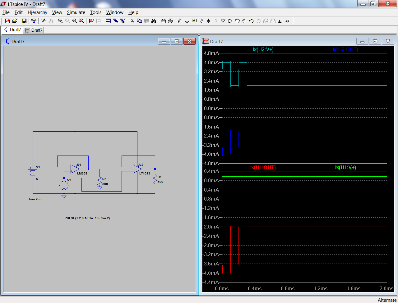

Maybe your models have the same problem as mine. The 358 doesn't seem to get it's current from it's Vcc pin. The LT models seem ok.:facepalm:
It is common for the VCC and GND pin current to not be molded (at all or correctly) in spice.
Some amps will run with out the VCC and GND connected. (only in Spice land, not in real life)

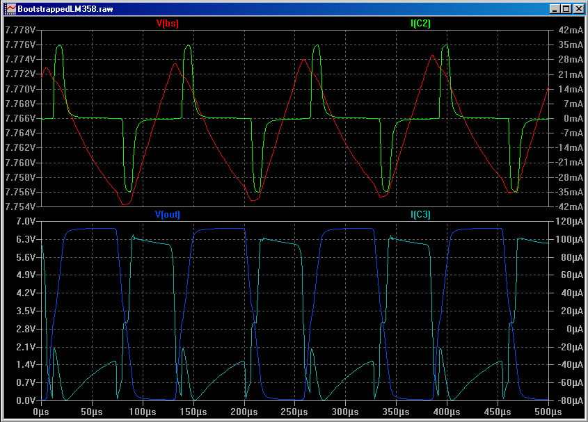

The LM358 model in the LTSpice sim I posted does correctly model the current flow from the Vcc pin to the Out pin when the OpAmp is sourcing current, and into the Out pin to the Vss pin when sinking current. It also does a credible job of modeling the magnitude of the LM358's source and sink current, including the Vol and Voh...
In the running sim, the peak charging current to my C2 is +-32mA (see Green trace on attached plot). That comes from the output pin of the LM358, so that same current alternatively flows into the Vcc pin or out the Vss pin. Note the dark Blue trace V(out). As you would expect, the LM358 will only pull within ~1.5V of Vcc when high, but pulls almost to Vss when low.
I also plot the current through C3 light Blue trace and V(bs) Red trace. Note that the current is very small because it is just acting as a bypass and the delta V is small too.
Hi Mike,
I dont see i(C3) all i see there is Vbs, Vout, and i(C2).
Where is i(C3) ?
Hi Mike,
Where is i(C3) ?
Sorry, I posted the wrong image. I fixed it. See if that answers your question...
i(C3) is the most important thing to look at. As we can now plainly see, we dont get the current we would expect in a normally operating voltage doubler. 100ua peak at 35 percent duty cycle means an average of 35ua, not nearly enough.
With a 33 percent duty cycle if we want to see 1ma of useful current for the other half section of the op amp (the goal) we'd need to see at least 3ma peak through C3.

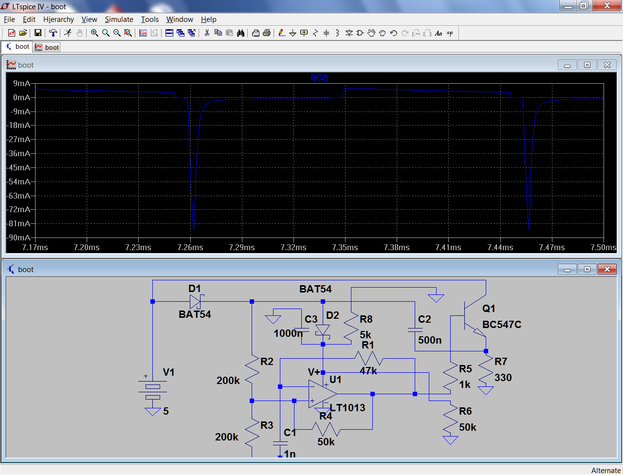

ronv:
Could you post your simulation results too?

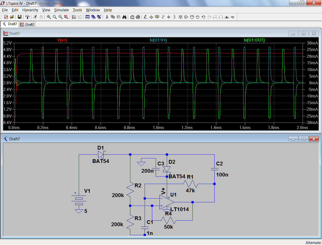

Sure. I used the LT1013 as my 358 draws no current from the supply.
  • boot.asc
A take away from Carl's that gets the power from 5 volts. Also in the running for ugly schematic contest.:meh:

ronv:
Yes that looks like the min requirement, at least one transistor. Maybe a mosfet would work nice too.
Mike:
Yes, with 35ua average current we can charge a cap up to 100 volts or more, but we can never draw 1ma from that. In fact we can never even draw 36ua from that for any reasonable length of time.
I had this idea several years ago and built a version to supply the V- for a quad amp. Al's and Mike's circuits don't work for the reason RonS has illustrated. Cruts' is better but has another problem: when the output of the amp goes above Vin, the base emitter junction will be forward biased and the charge pump cap will again be shorted out. To stop this you put a resistor in series with the base, as RonV has done. The other transistor , PNP in this case , can be replaced with a diode, cathode to amp output. The V- one I built and tested used a diode to charge up the cap when the output was high, and a PNP ( with base resistor ) to transfer charge to the resivoir cap when the output went low. The other sections were only minimally loaded so I don't know how much current this circuit supplied.
