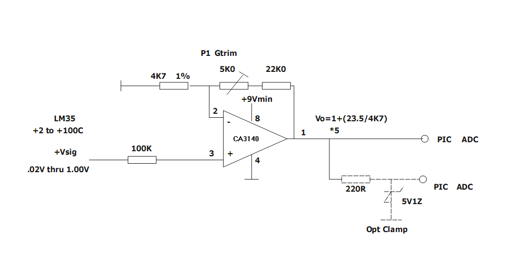

Look at this amp.
Set the gain to give +3.3Vout at your required max temperature.
The LM35 and the amp draw very little current, use a 3 or 4 core cable system.
+V, 0V, Vout, spare.

9V min, so maybe 2 stacks of accus. Lot of work (8 sensors=8 amps), should try if it works without and add the amps later. Just moved in, heaps to do in the house. Data logging is just one of it, want to check if the house improves with the things I have in mind. As long as all 8 sensors do the same I can at least see the differences. Say between outside and inside temp. (pretty much the same at the moment)
