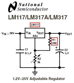

tab a said:
Is the 120 ohms value something you've calculated? I ask because in reading through several manufacturers' data sheets on the 317 I didn't see any reference other than something like "240 is often used".
Many people get away with using the wrong resistor. Each IC is different.
On the first page of the datasheet for the LM317 is a circuit with 240 ohms. The IC is the more expensive LM117, not the cheaper LM317.
The datasheet lists a max operating current of 5mA for the LM117 and 10mA for the LM317. This operating current flows through the resistor if there is no load and causes the output voltage to rise if the operating current causes a voltage higher than 1.25V in it.
Do the math: 10mA through 240 ohms = 2.4V. 10mA through 120 ohms = 1.2V.
Use an LM117 if you want to use 240 ohms.
I wish National Semiconductor would change thier datasheet,it's probably confused designers the world over.
