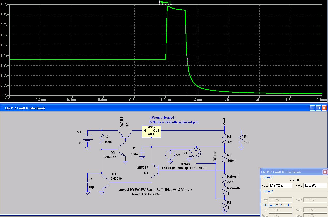

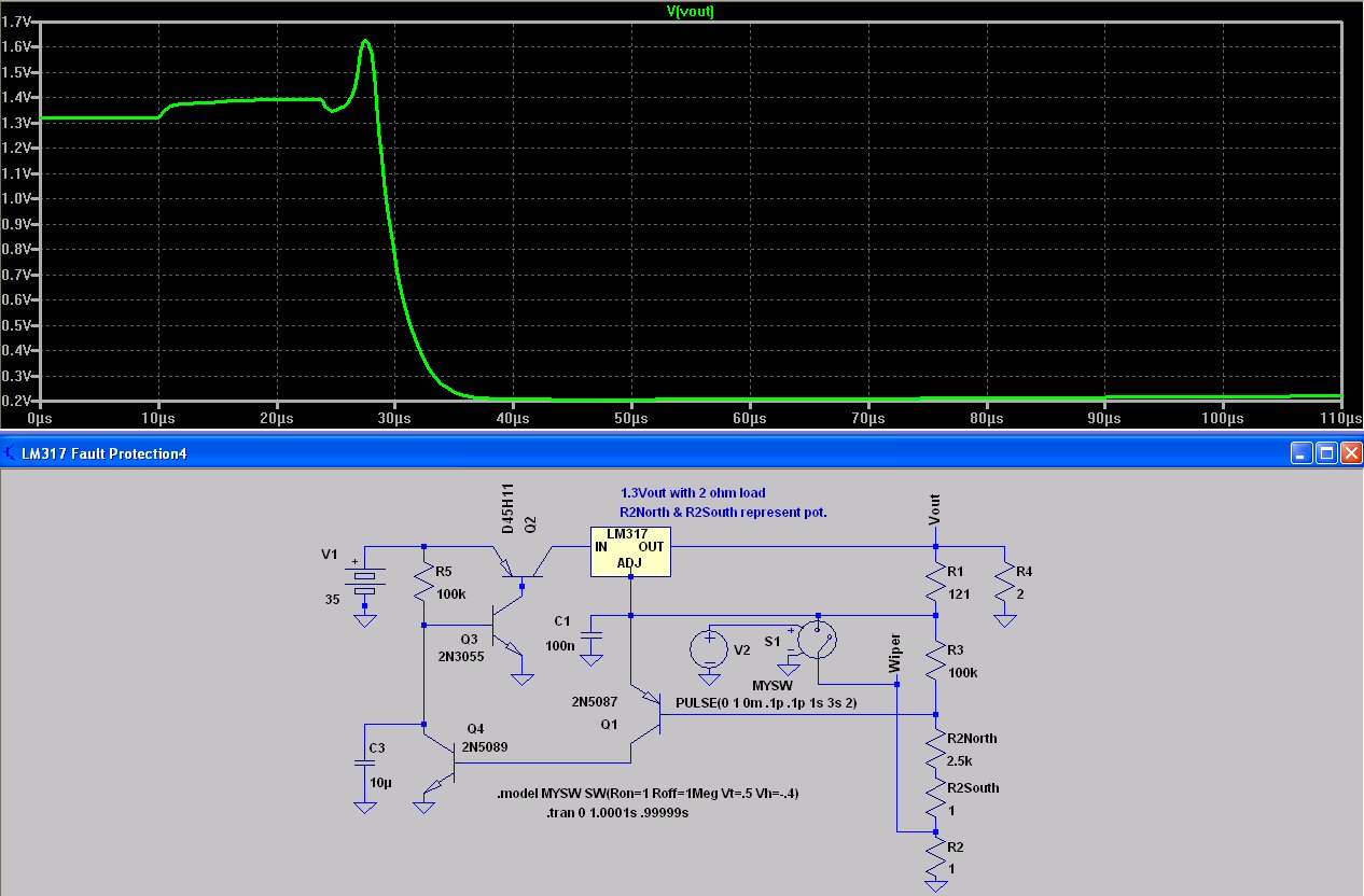

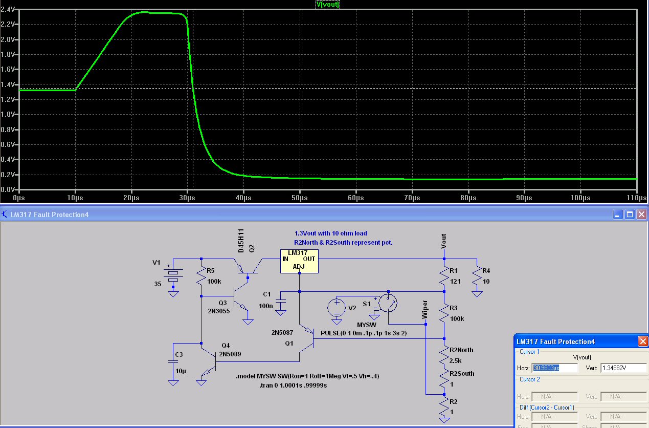

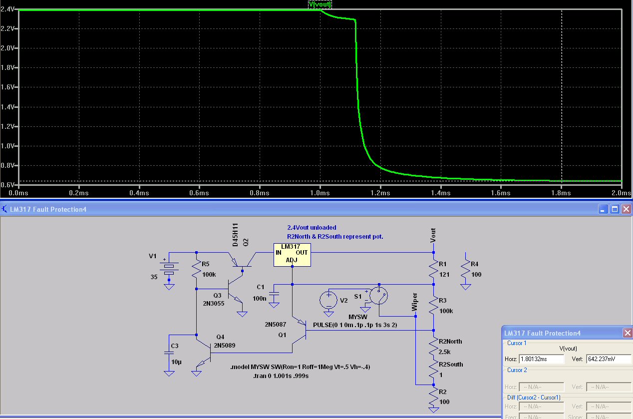

Well, between the honey-do projects and prepping for our Tues. departure for our summer on the Western Slope in Montana, I have come up with something that is close to the outlined parameters, but not at all the best solution, even given it is my forth iteration. I worked the problem from the supply side to reduce any thermal stress on the regulator, vice your works' on the other side.
First note that the 2N3055 (Q3) is not what should be used, but it was in the library, and I didn't take time to cross check the few NPN's there with a more suitable substitute that would handle the full output load. The value of C3 is critical to reduce any chance of oscillations during fault condition. R2North & R2South represent the potentiometer, and R2 is the "lift" resistor to take the minimum output to 2.4V. Without R2, there is an overshoot from 1.3V to ~2.4V because of the propagation time to shutdown Q2, the pass Xistor. The overshoot varies with the load from ~6.5us to 40us, full load to no load respectively.
I've included a series of sim screenshots depicting the behavior. Above 2.4V, it appears to act properly to full voltage with varying loads, shutting down the supply voltage to the regulator to ~2.5V with ~0.65V out of the regulator.
The one inconsistency noted was that the model of the LM317 seems to "fold" in current overload at approximately 50% of that in the data sheet regardless of overhead and output voltage. I tried the LT1086, a relatively close match to the LM317, and it was even worse. Neither matches the datasheet curves or derating data as far as I have found. I could be wrong here, but...
Cheers,
Merv

Hi Merv,
Yes as i was saying previously in this thread, the model for the LM317 is probably outdated and R26 should be about 0.05 rather than 0.1 or something like that. Try that for some better results.
I think i like this new solution too. One little thing though is it looks like after a certain time the output gets enabled again (after the 10uf cap charges up again) because the drive for keeping it low disappears once the power gets cut. If the oscillation period is long enough though it might not matter i guess.
Just something to think about.
Hello MrAl,
I guess I should update the .sub file then for the LM317...thanks!
Regarding your second paragraph, I ran that test and knowing that the input voltage to the regulator isn't clamped to zero...that would cause severe oscillations and make the scheme unworkable owing to regeneration once the near-ground potential was removed from the base of Q4. The frequency of oscillations would be in the range of several hundred Hz up to ~71KHz based on loading and level of Vout at time of the fault.
I ran the sim out to 100 minutes with only two pulses representing a fault condition(please see the pulse setup in the attachments). There was no regeneration of the output after the second and final fault. Note that the input voltage to the regulator is not clamped to zero but to ~2.5V allowing the Q1 to continue in conduction to supply the bias voltage to Q4 just enough to supply base current to Q2, via Q3, to set that condition of the ~2.5V into the regulator; the 10uf cap serves only to dampen the possibility of oscillations at the initiation point of the fault sequence.
Now if it will work in the real world is another question, owing to the Spice modeling of the transistors employed. That's where real-world prototyping, on a real board, comes into the realm of gathering emperical data.:D
Cheers,
Merv
