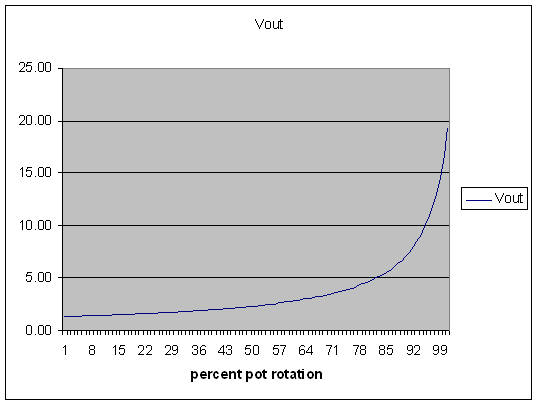

The problem I have with this method is that Vout is a very nonlinear function of pot rotation. Attached is a plot that I did on Excel, using Carl's example. An LTspice simulation gave a virtually identical curve.
Good observation. And I don't see any easy way to make the circuit output voltage more linear versus pot rotation.
Sometimes, simple doesn't work.
Of course, you could make a feature out of the nonlinearity. You get better setting resolution at low voltages, where it's more critical.;)

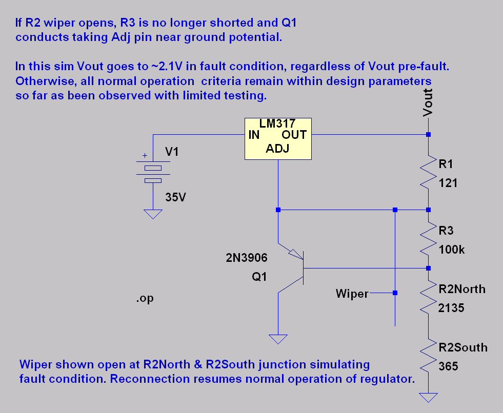

I thought I should contribute something more than critique. Got started this morning, and here is what I came up with. It's just a shunt and appears to behave/operate without issues so far as I have tested. Some details are in the attached schematic.

Excellent, Merv! You are a genius!
I ran some transient sims. According to my sims, the output will overshoot and/or ring during wiper recovery if you don't have around 10nF or more from ADJ to GND.

I did not run any transient sims owing to the fact that I was ignorant of how to switch the wiper. After reading your response, I did some searching and finally found the voltage control switch, and figured out how to manipulate it after a fashion, being very motivated to do so when seeing your nick in the Spice directive. ;)
Yes indeed, there was potentially destructive overshoot at the 5V level I tested at with an 8Ω load or unloaded. Following your advice, I experimented and found that a 220nf integrated the leading edge of the rise nicely and helped reduce the overshoot on the lead of the falling edge to a reasonable level also. The rise at 28V takes about 4ms to rise back the programed voltage, which I think is reasonable at that level verses too much overshoot at 3.3 or 5V, which could be destructive.
Thank you for the compliment, and thank you for pointing out the shortcoming in my proposed configuration.
