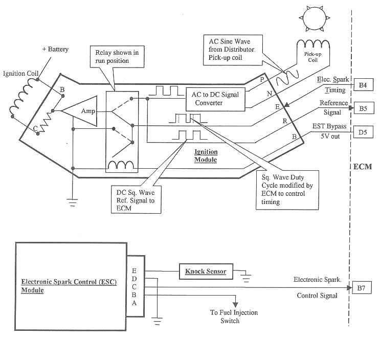

Is this is a Kettering Points-Condensor-Coil-Distributor type of ignition, or is it a more modern transistorized ignition with an ECU?
If it's a module like this
then the safest place to get a signal from would be the pickup coil of the distributor.
