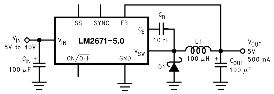

I want to use a "LM2671" as part of my project to output a 5v so I can charge a mobile phone using a USB cable. The voltage input will be around 12V.
The data sheet for the component LM2671 is:
https://www.farnell.com/datasheets/1640746.pdf

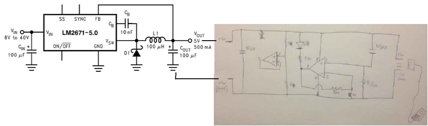

I have attached a picture to show the circuit I will be using:
My problem is I would now like to attach an LED to this circuit so I know when the phone has finished charging. Does anyone know how I will be able to do this please?

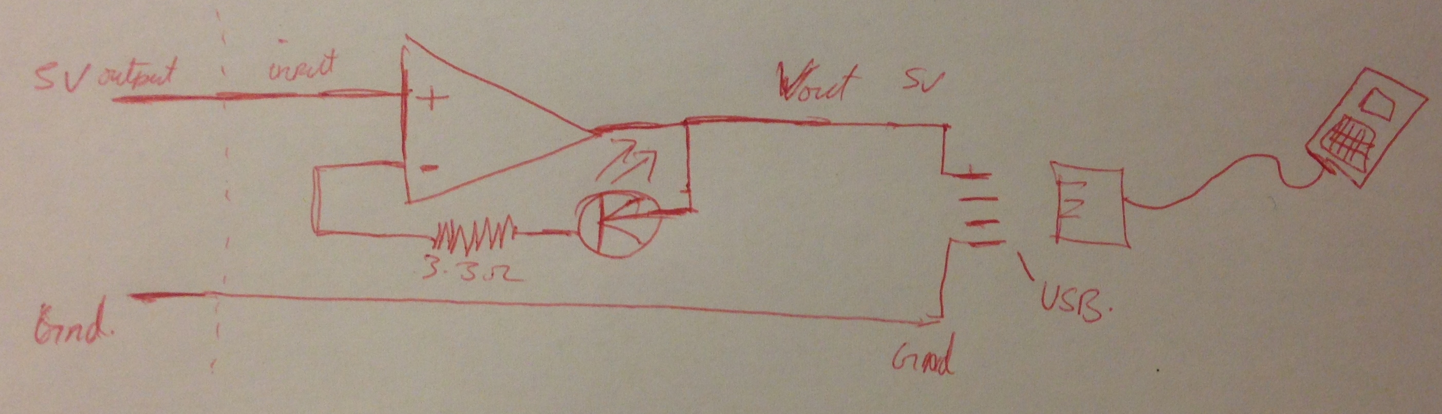

Would something like this work?
Thank you

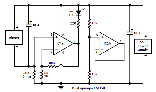

1) You have the 5V power supply connected to the input of the opamp instead of powering it.
2) You have the output of the opamp connected to the phone but its output cannot supply enough current to power the charging circuit.
3) You have the LED in series with the very high resistance input of the opamp so it will never light.
I used a 3.3 ohm resistor as a current sensor for the charging current to the phone.
I used the first opamp as an amplifier with a gain of 101 times. Then when the charging current is more than 10mA the output of this opamp is high which turns off the LED. When the charging current is less than 10mA then the output of the opamp goes low which lights the LED.
I disabled the second opamp.
An LM358 dual opamp is used because it is available almost eveywhere and has inputs that work at a voltage as low as ground.

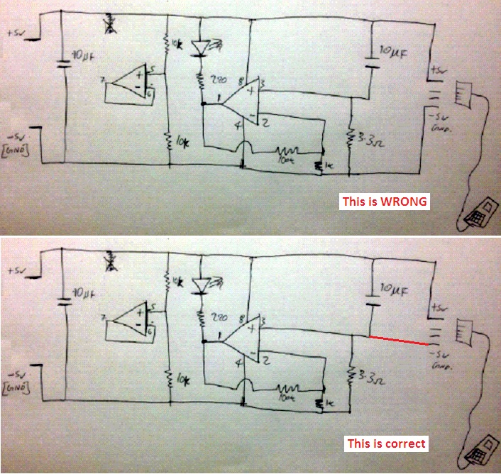

So if I was to connect the circuit like this, would it work how I want it to?
Thank you
No.
Your circuit will not work because the current used by the charging circuit in the phone does not flow through the 3.3 ohm current-sensing resistor.
Then the output of the opamp will always light the LED.
It should be like my last schematic like this:
No.
Thank you
I will try and simulate it as soon as I can on ISIS.
Your SIM program might not have an accurate model of the LM358 dual opamp.
Why simulate it? Instead, make the simple circuit and test it.
