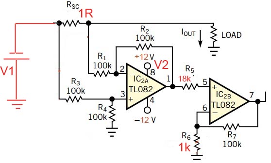

If the voltage of V1 is greater than -12v it should work,
The battery V1 is drawn backwards. It should be +40 volts or +30 volts. (some thing +)
I am worried there is a dead op-amp or we are working outside the input operating range of the op-amp.
So right now it sounds like something very elementary is wrong, and could even be a bad op amp IC.
You are right. In the bread board I connected high side of Rsc with pin2 and low side with pin3. But in my actual psu PCB the connections are ok. The psu max output voltage is about 37v which may be way above common mode voltage range of Tl082.
I replaced it with Lm358 in the bread board and now the opamp output is near the expected value (tested with psu output around 10v) .
So far I know upper limit of LM358 CMV is less than 32v which is below my psu max output (37V). Can you suggest me of any other common op-amp IC which will support full range output of my psu. (I'm using the op-amp for current limiting of my variable psu made with LM2576 which operates at 52kHz)
With R1,R3=100k the voltage range is +24 to -18.
With R1,R3=200k the voltage could go up to 36 volts. (the gain goes down)
Bottom line is to increase R1,R3 or to increase +12V.

Another way is to use TI's INA282.......INA285. It is what you are trying to make. 80V max
Maxim's MAX4372 is a slightly different way.
The part number I wanted to use can only work with a supply range of 7 to 65 volts. I think you need a range of 0 to 40V so watch out for input voltage range.
What if I use 47k for R2 & R4! Theoretically by the voltage dividers both pin2&3 will get less than 12v when V1 is about 37v. The common mode voltage will then be (v(pin3+v(pin2))/2<12v. Is this process ok?
I like to give credit where credit is due, and that's good thinking on your part. Not only do you meet the CM range that way, you also keep the resistor values at 100k or below which reduces the inherent noise as well as the chance of external noise pickup. Less that 20k even better if that is possible because this is part of a switcher.

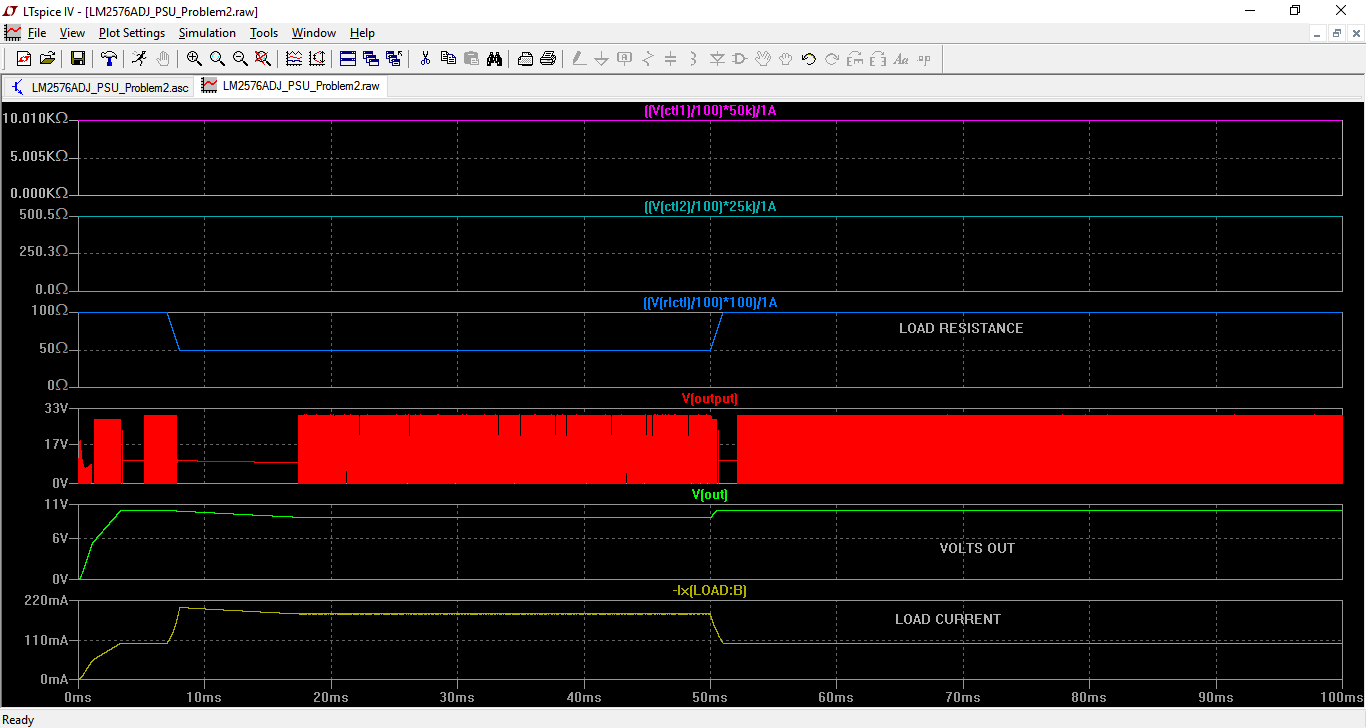

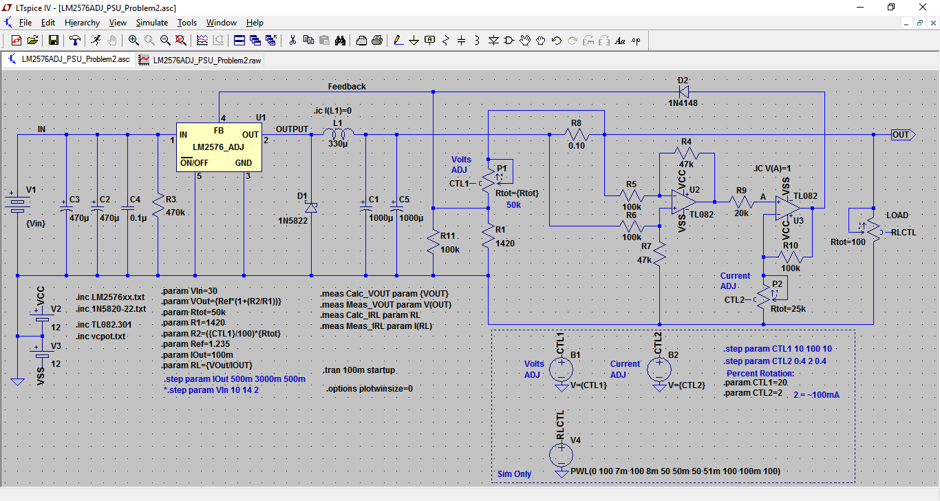

This is an interesting thread. Out of curiosity, I thought I would try to sim and share the results.
The circuit doesn't seem to be current limiting. Output should be 10v limited to 100mA.
See attached.
See attached.

Here is LM2976 spice model. The subckt file contains both fixed and adjustable models.
I used the built in symbol "opamp2" for the TL082 model.
Have fun. :)
