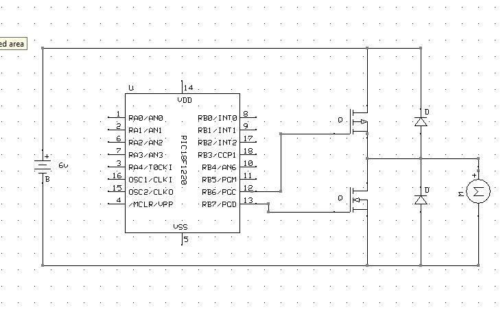

ok so say i stick with mosfets, will that allow 6v to the motor but fed from an output on the picaxe?
is this correct?

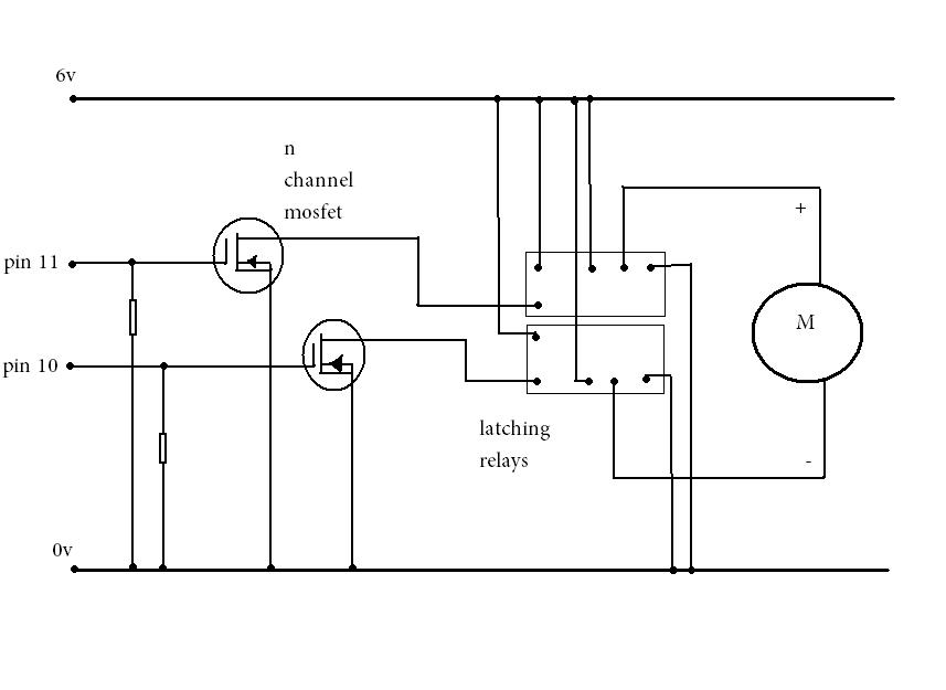

also i had a small thought, i was thinking something like this.
to move the motor forward make output 11 high 10 low
and then it hits my limit switch which halts the operation
lets say the limit switch is on input 9 is switched high it stops the motor
my question is if i then reverse this process to make the motor reverse will it not just keep cancelling itself out because input 9 is still high?
or can you program this to just be a single signal and not a recurring signal?
