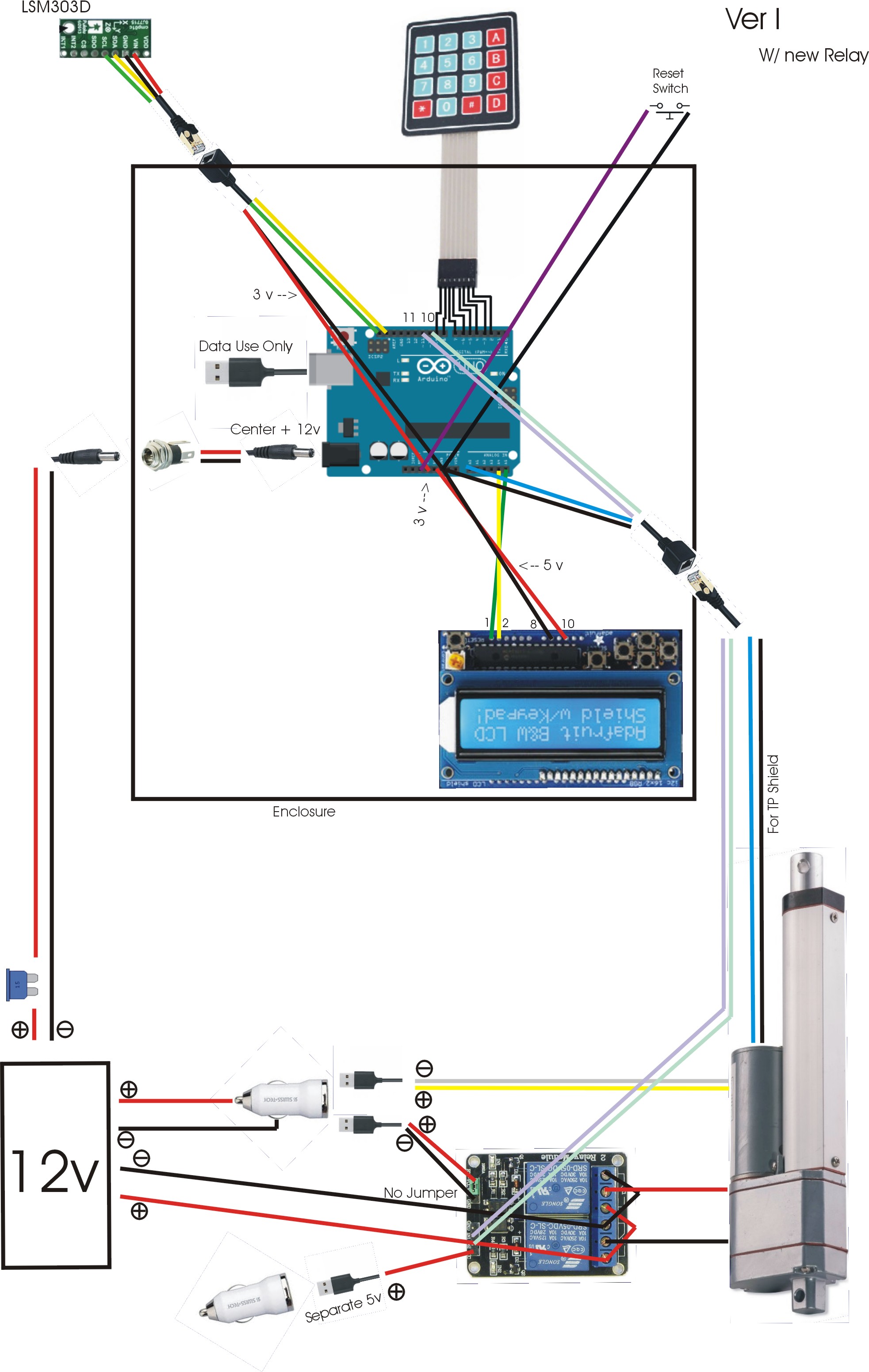

Thank you for your reply. I don't know how to draw a proper schematic, but I do have a picture of the circuit. I did my best to properly place the connections over the pictures in their proper spot. Thanks once again for your assistance. I'm learning. Circuit.JPG
The relays are de-glitched on the relay board. I like that your -12V lines are all returned to the - lead of the power supply (single point ground, motor current not flowing anywhere in the Arduino PCB); that makes ground-loops less likely.
Try it.
If you get noise in the AD input from the positition pot, put a 10uF capacitor, + to the AD input, - to Uno local GND. A 0.01uF disk ceramic capacitor between the red-black motor leads (close to the motor as possible) might help...

The readings from the actuator (wiper) are fluctuating a bunch. The range of the actuator is (fully retracted = 112, fully extended = 912). If I tell the actuator to move to let's say halfway (512), it goes to that location (within my dead band forgiveness) and stops but, the readings coming into the arduino fluctuate about 50 points (values?). Id like to tighten that up a bit. Part two is, while the thing is running, it will lock up the arduino and everything will stop after a few seconds. It's completely intermittent. Sometimes I can get about a minute before it stops, other times, only a few seconds. If I remove the actuator from the circuit, the thing will run flawlessly.
Try it.

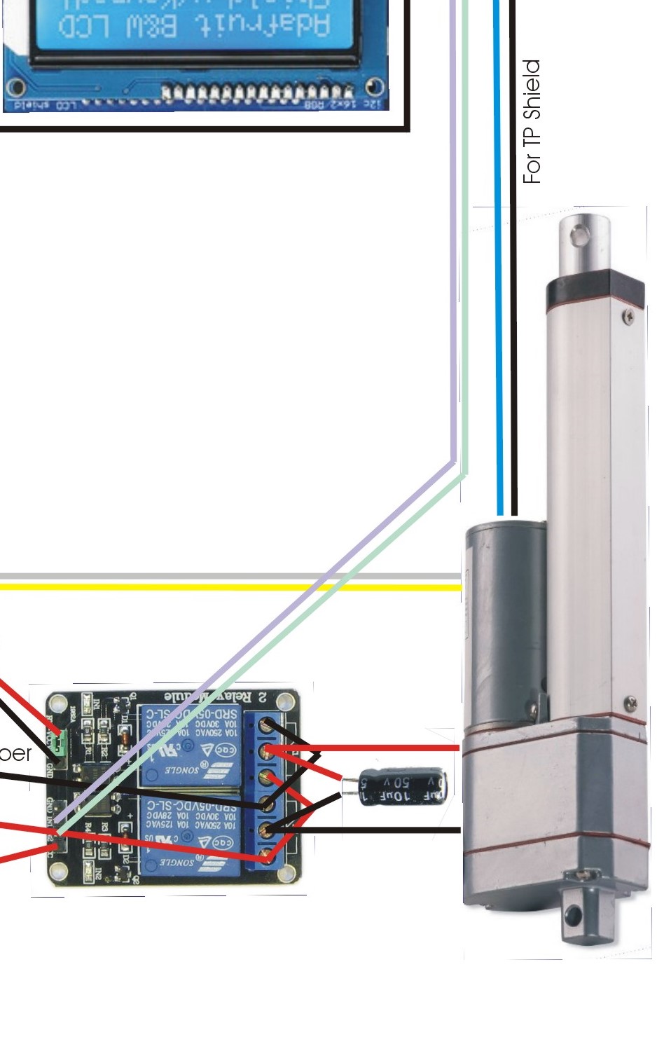

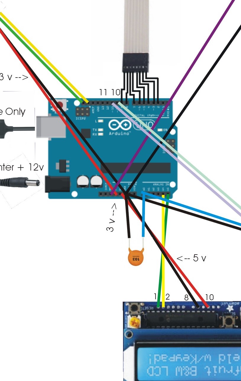

Once again I need to say "thank you" for all your help! Additionally, since i'm very new to this sort of thing, I made 2 illustrations of where I think I understand where you are telling me where to place the capacitors. If you could take a look and let me know if I'm understanding correctly? Thanks once again. Circuit-2.JPG Circuit-3.JPG
10uF across the AD input; not the motor. The largest capacitor I would put across the motor is ~10nF (0.01uF).

Ok thank you, looks like I got it backwards. :-(
