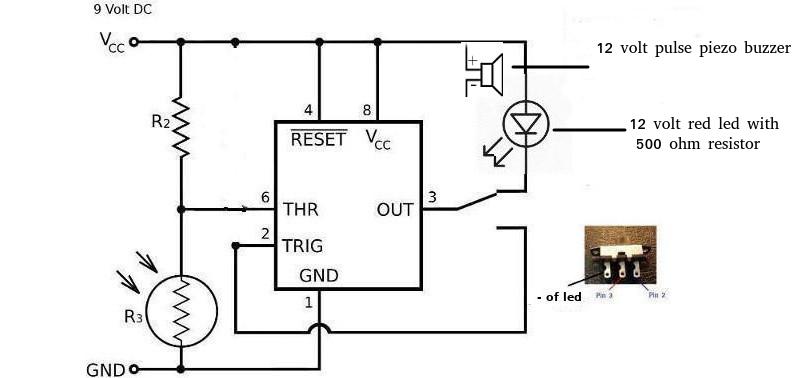

Please post the schematic of your final working circuit with the 555 connected as a 5 minutes timer. The other schematics you posted do not work properly.
118324
The photo does not show the schematic, instead it shows a photo of an intermittent solderless breadboard with messy wires all over the place.
None of the parts or wires are labelled.
The wiring of the pot is not shown.
You see the dimple on the chip or you should.
Then you can tell which pins are which.
The other photo shows where they go to.
I even used different colors to make things easier.
I do not have hours to spend learning a circuit diagram program.
You should spend less time criticizing me and be a cheerful giver.
You are NOT a most helpful member.

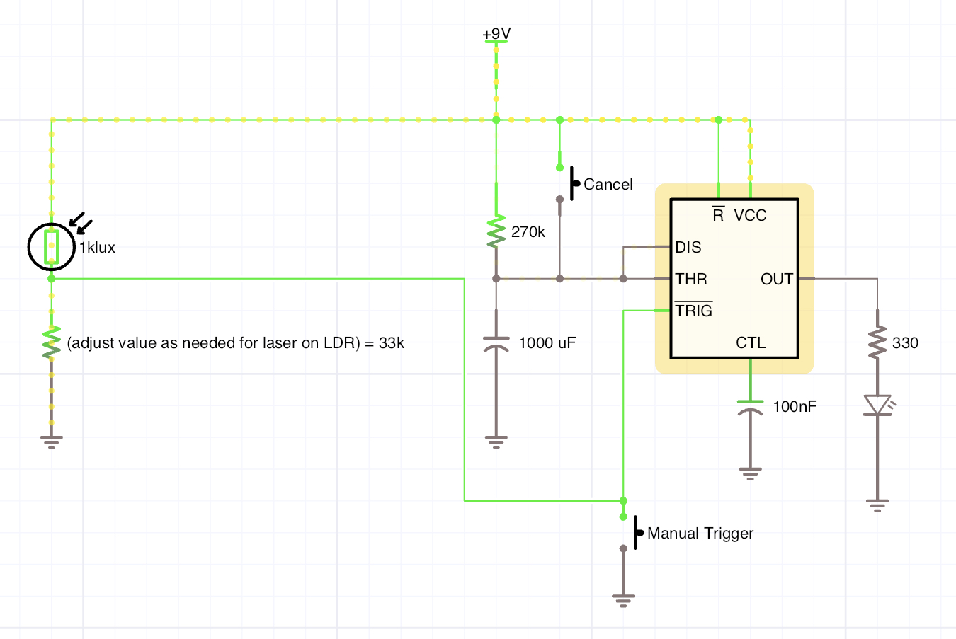

Here is a better circuit that triggers when your laser beam is broken. Whether it stays on for 5 minutes depends on the quality of your 1000 uF capacitor - yo need one with low leakage or you mA need to increase the resistance of the 270k to 330k or more.
The "test switch" allows you to trigger as you want.
Cancel button turns of the LED immediately.
I like that circuit but I would replace the 270K with a 500K pot and make sure, as mentioned, a low leakage quality cap.

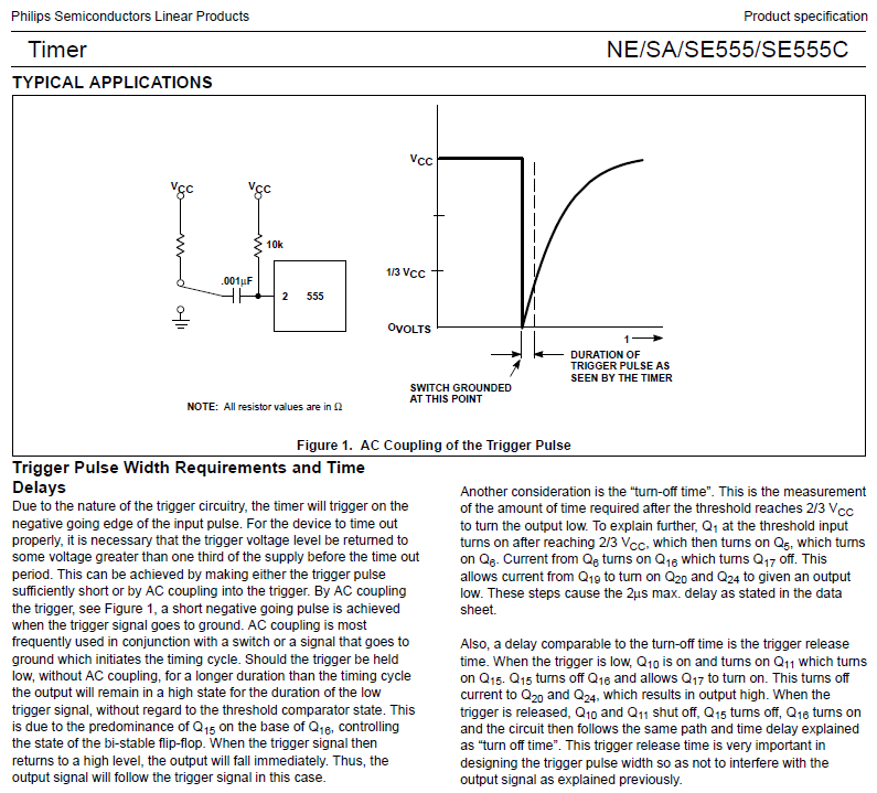

Gophert, your timer will not timeout if something blocks the LED (a parked truck?) for time longer than the timeout.
The original circuit has the same problem.
thanks, I will try it out.
Is one switch a SPDT switch and the other a momentary on switch?

Both switches are momentary but you can definitely use toggle switches - just flip and flip back.
Also, low leakage are not "Required", they will just help get the "actual" on time close to the "theoretical" time from the published calculation for 555 timers. I would just use any 1000uF and adjust the resistor.
Thanks. I field tested my circuit on my patio.
Without the laser, ambient light is enough to keep buzzer off.
I passed my hand over the LDR from about a foot away and it sounded.
But it won't work from about 6 feet away which is about the range I need.
So it looks like even with a laser shining and someone breaks the beam, it may not sound if the light level is high enough.
