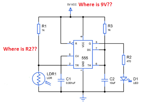

While I am waiting for my pot to come in, I thought maybe this might work.
I have many of the components that it requires already.
Could it be modified to set off a piezo buzzer in addition to the led?
A modification is not required. Simply connect a piezo beeper to its pin 3 and to the circuit ground.
I think the 1k resistor value is too low to feed the LDR. I would use 10k.
I did so. Nothing happened.
I am waiting on a 25K pot.
R1 must be 100k or more. You'll be lucky to get R1 down to about 12k and pin 2 must fall below Vdd/3 to trigger.

The circuit schmatic shows R1 and R2.
I am only using R2 because the author said R1 is often not necessary.
I wonder if lack of R1 is the problem?
The schematic wrongly shows 5V so we are talking about the problems of using 5V but he is using 9V, not 5V.
The schematic does not show a pot but he talks about getting a pot. Where will it be used?
The schematic does not show an R2. It shows only R1 as 1k ohms which is much too low.

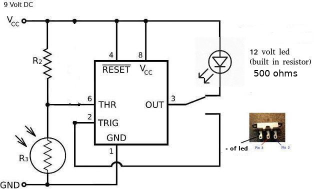

Sorry about the mixup.
This is what I made.
With no laser, led lights up.
With laser, led goes off.
Since my piezo buzzer did not work, what else can I use to make a sound?
118300
As drawn the LED is backwards. When pin 3 is low nothing will happen and when pin 3 is high nothing will happen. Why are you taking the out and routing the out (pin 3) back to the trigger (pin 2)? Note I said "as drawn" the LED is backwards.
Take your LDR and just place it on the bench. Measure the light and dark resistance and note what they are. Learn how to use a transistor on the output of the 555 for increased current loads.
