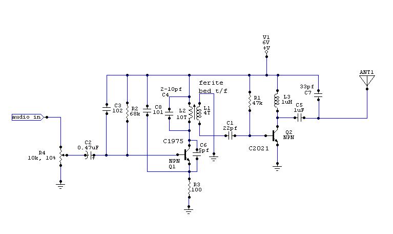

Try the attached one, i made it as hobby 15 yrs before and the frequency stability was not so bad and the range was in commercial FM band. can be tuned easily.
there is a Ferdie bed transformer same as IF transformer having two windings as in the drawing. that can be varied to bring to the required frequency or the 2-10pf capacitor can change the frequency.
on eBay i have purchased tiny modules with FM stereo modulation, programmable to some discrete frequencies.
Edit: L3 is 10 turns 36 wire
This circuit looks cool, if I get the parts for it I'll build it. The reason why I built the one in the OP is because I had the parts. :p
