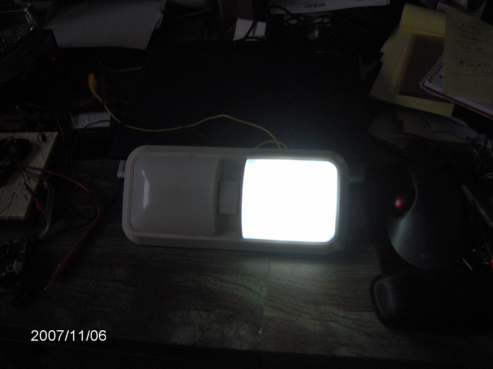

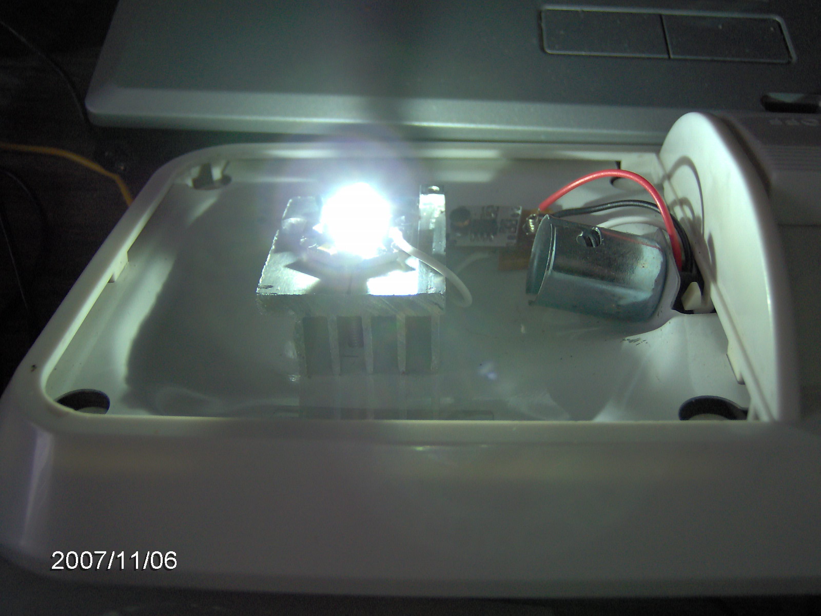

Here's my piss poor attempt at an led lamp. Well it turns out to be a good mood light, that's about it, don't have to burn a candle. It hot spots the lens.
