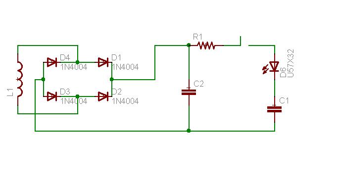

conserving energy
C2 is initially charged to say 30 V..
C1 is 0V..
R1 is 2K ..
LED is a white ~ 3 V forward voltage drop..
when switch is thrown C1 charges up to C2 voltage minus the LED diode drop..
But the beauty of this configuration is C1 still has about 27 V in it..
the problem is C1 only took about a second to charge up :( ..
but the energy is still in the system..and the white LED had a respectable 4 mA going through it..
am i just delaying the inevitable?
or can i use the energy stored in C1 to repower the LED later on..somehow??

when i put a 3V lithium battery in place of C1 (same polarity as C1, plus at top ) the led stayed lit for about 7 mins.
only using about 1mA current..
how about using a rechargable in place of the lithium battery or again a super cap. ..??

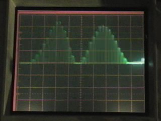

this is how i was able to get over 300mA ..
scope is set @ 5V /div 20mS /div..and scope is connected directly across the bridge rectifier and a high value resistor to cut down on ripple from the diodes..and without the transformer connected..
Out of 180 mS , two passes , 140 mS or so , of it , is a non zero value.. :D

I see a peak of 15V, an average of about 6V and hardly any current into your high-value resistor. How did you connect a current meter to measure 300mA?

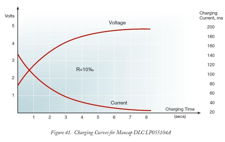

i ordered (10) .22F super caps last night . At 5.5V they could hold 33J energy..
Below is a charging curve for one of the 1F caps i believe..so the actual charging time will be less per cap but i have 10 so i figure 30 or 40 seconds of shaking should charge them ..
