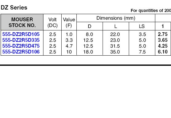

they sell a 10 F 2.5V super cap with an internal resistance of probably 1.0 ohms..
if i get two maybe i can charge them one at a time..
LOL we shall see about how long it actually takes to charge..

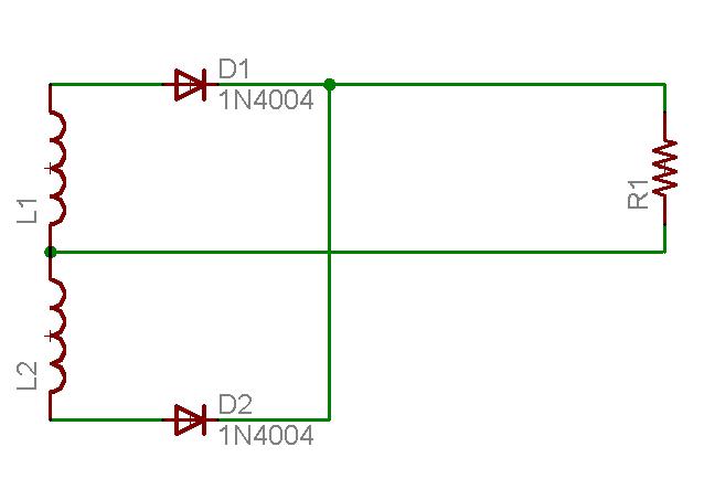

I have thought about using Mosfets , but this is a simple configuration that you really cant beat .
i have been able to get 143 mA out of it , with R1 being a 1.0 ohms , and measuring voltage across it..

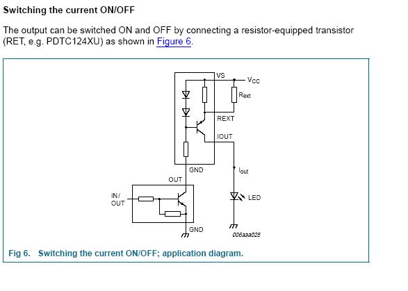

I seen an litle circuit that ajusts the curent acording to the voltage it can even run from an lover voltage than the LEDs forvared breakdown (It can drive an white LED from an empty 1.5V button cell)
But i dont think it works at such high powers for an LED light
i wonder if i could use PWM to turn a constant current source on and off ??
Blinking the LED would extend the power used , for sure..
That was an simple 1 transistors circut
