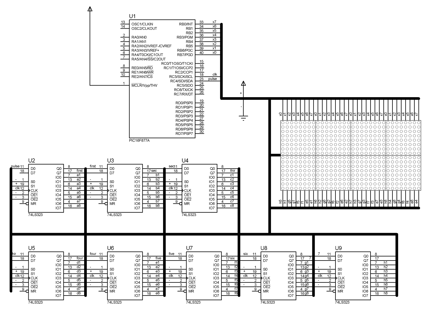

I also did a 32x16 led display that runs pretty smoothly... It is driven in the same way as a LCD screen..
But I used 74LS323 shift registers....
The screen gets dimmer the more LED's you have... As the end result will theoretically have two screens it should work okay..
Moving to MikroC isn't a big deal.... I have XC8 compiler and MikroC for pic32's so I should be able to help!!
I use interrupts to drive the screen, that's why I have a flicker free display... There is a "off screen" display that I can flip...

The schematics:--: Remember I don't have the resistors on the circuit as the simulation is too slow..
Each column needs a resistor to prevent LED or micro failure!!!

What is 323 registrr is this?
And i have google bidirectional shift register
Any shift register will do... I just don't want a latching feature as it is a constant update.. hence the screen / back buffers..
