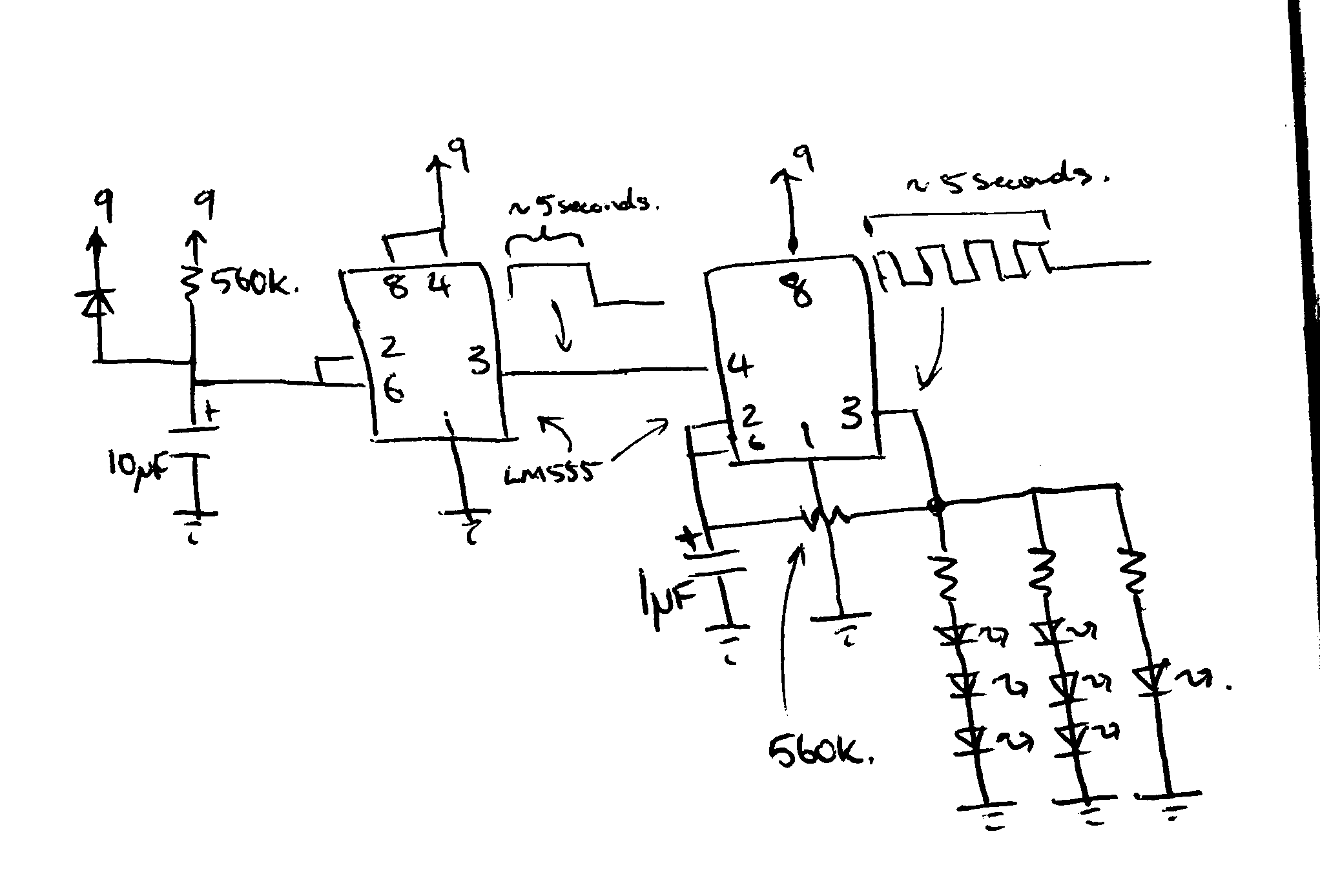

Hi guys,
I have a current project which requires me to light up 7 LEDs in series using a on/off switch, blink for 5 secs (timing can be more) at the same time and turn off.
Is there any available circuit similar to this application? It has to be mobile as well, I'm thinking of powering the circuit with a typical 9V battery. Not sure if it is enough.
Any idea?

What I need is for the 7 LEDs to be turned on together, blink for 5sec and turn off together. In this case, what should I do? Is there any available circuit which I can follow? I am really bad at designing circuits and hope to get a full circuit solution if possible. This project is too tough for a 14 like me. :(

Appreciate your reply! This sounds tough to understand. :( Any available circuits for me to turn on 7 LEDs, blink for 5 sec and turn off?
You can use two 555 timers, like shown in the following schematic. I didn't mark the resistor values in series with the LEDs, but they should be (from left-to-right) 180R, 180R and 420R.

This also can be done with a single NAND gate, or a combination of gates. Here are two schematics to show this. The functions are the same as the two-555 approach: an ON timer, enabling an oscillator, driving the LEDs.

You can't drive 7 LEDs in series with 9v.

It wont last longer than a day or 2 on a typ. Alkaline 9V
Can you use 8 instead of 7?
I use 10,000 mcd 30 deg @20 mA @2.0 to 2.1V Red or Yellow (630 nmD or 590 nmD) LEDs which would plenty bright on 3~5mA for most App. .... Blinding on 20mA at arms length.
For more constant brightness use 3S2P + 1S as suggested already but then 3 strings of current means 33% shorter battery life.
Timing is pretty easy. Search google "images" for "Schmitt Relaxation Oscillator" Using a big R to slowly charge a big C, the RC product gives the rise time of T seconds will be equal on and off. I suggest a good quality 1uF cap (low leakage uA spec) and R= 4.7M for approx 5 second On then 5 s off.
Ohm's Law is used to compute voltage drop between Vcc =battery and LED string . For 8V string and 9V battery, the LEDs will gradually dim as the battery drains to 8V.. Other methods using a string of 3LED of a red or yellow sum of 6V will allow the battery to drain fully but then consume 33% more current with 3 strings vs 2 , so , duration is not improved.

Running at 5mA per string x2 may get you a week runtime....

I don't know about the rest of the circuit, but do not put LEDs directly in parallel. The string with the lowest sum of Vf will hog all of the current. Place a 220Ω resistor in series with each string of 2 or 3 LEDs.
Ken
there are situations where running in parallel can cause thermal runaway with current hogging, such as when parts are badly mismatched. Using separate R's rather than sharing is advised if you can be sure by testing each string with a bigger R to meaure the drop or if you know your supply is from the same bin , which is normally done per bag from the factory, but distributors might mix bags.
All my LEDs that I get are matched so parallel strings of several or more is no problem for me. It is common practise for factories to shunt strings in parallel when driving less than rated and much lower risk compared with all in parallel running of a 3.7V LIPo ... Unless you know your LEDs are matched.
In this case, it is trivial to separate Rs for the two strings at 2x values.
Ideally the number of LEDs in the string leaves less than 1 LED drop on the current limiting R, where Ohm's Law applies.
