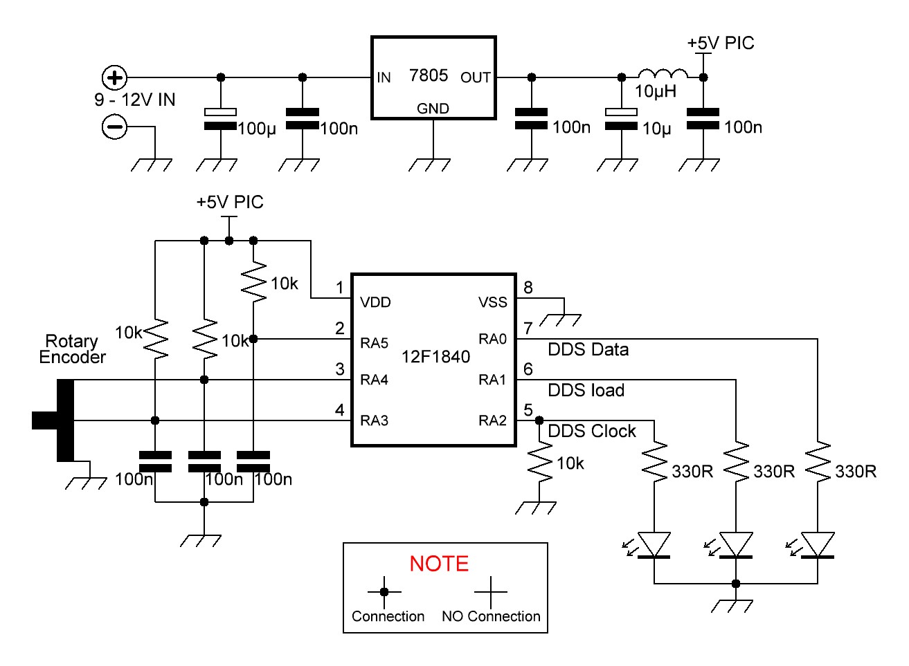

In that case just do
encoder_count = table[(previous & 0x0f)];
Note the missing +.
Your mainloop will need to check encoder_count and use it if it's not zero and then set it to zero.
Also, define it as a signed char.
char encoder_count;
or
int8_t encoder_temp;
OK, dumb question time again - char encoder_count; - why char and not 'int' or something else? (bearing in mind encoder_count will hold 0, +1 or -1.
In some of the 'stuff' I've been reading, several authors seem to explicitly state that 'char' is for, well, characters as in letters - a,b,c etc - for putting up on an LCD or some such display device.
I'm working towards getting one LED to light if you turn the encoder one way and a different LED if you turn it the other - I think I've got all the bits of code written/modified as needed and will string it all together later and see where I've stuffed it up.
Char is a single byte variable. On a 32 or 64 bit PC then it's much quicker to use an int but on a micro controller it's better to use char or as I prefer int8_t or better still, unsigned char or uint8_t.
Edit, in this case it has to be signed but where it makes no difference it's quicker to use unsigned.
OK, I've got to this point with a lot of hair loss so far, it compiled (apparently) but I haven't run it on a chip yet and it generated the warnings show after the code so I obviously haven't got to grips with calling functions properly yet The EEprom bit at the bottom is from a post further back and can be ignored at this stage.

And the warning messages are:
newmain.c:74:24: warning: implicit declaration of function 'encoder_click' is invalid in C99 [-Wimplicit-function-declaration]
       encoder_count = encoder_click(encoder_count);
1 warning generated.
"C:\Program Files\Microchip\xc8\v2.32\bin\xc8-cc.exe"  -mcpu=12F1840 -Wl,-Map=dist/default/production/Simple_VFO.X.production.map  -DXPRJ_default=default  -Wl,--defsym=__MPLAB_BUILD=1   -mdfp="C:/Program Files/Microchip/MPLABX/v5.45/packs/Microchip/PIC12-16F1xxx_DFP/1.2.63/xc8"  -fno-short-double -fno-short-float -O0 -fasmfile -maddrqual=ignore -xassembler-with-cpp -mwarn=-3 -Wa,-a -msummary=-psect,-class,+mem,-hex,-file  -ginhx032 -Wl,--data-init -mno-keep-startup -mno-osccal -mno-resetbits -mno-save-resetbits -mno-download -mno-stackcall -std=c99 -gdwarf-3 -mstack=compiled:auto:auto      -Wl,--memorysummary,dist/default/production/memoryfile.xml -o dist/default/production/Simple_VFO.X.production.elf  build/default/production/newmain.p1
newmain.c:74:: warning: (1518) direct function call made with an incomplete prototype (encoder_click)
You need a prototype for encoder_click, add,
Int encoder_click (int);
to the top of the code.
Actually, passing encoder_count is unnecessary, I'm away for the (long)
Weekend but will have another look on Tuesday.
I've trimmed up the code and been playing about with various things to see what happens (hence the commented out bits of code), but either my understanding of what this should do against what it is actually doing is way off or I'm going completely nuts.

1/ All the set-up.
2/ In to main
3/ Jump out to encoder_click
4/ Check if the encoder has moved
5/ If no movement the variable 'encoder_count' should = 0, if it moves one way it should = 1 and if it moves the other way it should = 0xff
6/ Return to main
7/ Take the returned value from encoder_count, place that in 'dir' and then light the approriate LED viz light the LED on RA0 for movement one way, light the LED on RA1 for no movement (or illegal step) or light the LED on RA2 for movement in the opposite direction
8/ Do it all again from 3/
What it actually does:
All from 1-4 above = OK
5 returns the wrong values
6 = OK
7 Lights the wrong LED in two situations (explained below)
8 = OK
LED's: - On first power up and the encoder not moved - LED on RA0 lights indicating returned value in 'encoder_count' is 1 instead of 0.
Turning the encoder in one direction, this time it will make the LED on RA0 blink, indicating 'encoder_count' is returning the value 1.
Turning the encoder in the opposite direction, the LED on RA1 blinks, indicating 'encoder_count' is returning the value 0 instead of 0xFF.
When the encoder stops turning, the LED on RA0 again lights, indicating' encoder_count' is returning the value of 1 instead of 0.
The encoder is one of those cheap detented things with 24 detents and it's rest state is both A & B outputs open, so with the pullups of the circuit, returns RA3 = 1 & RA4 = 1
Messing with the value that the variable 'previous' is preset with (0 or 0x03), changes which two LED's actually light, blink, do something - the above is with 'previous' set to 0.
My calculator says that, on start up with 'previous' = 0 and no encoder movement - ORing in the value of 'temp' (0x03) should return a value in 'previous' of 0x03 and that should pull the value of 0 from the table and put it in 'encoder_count'.
Then the next time through this code, again without the encoder moving, 'previous' is left shifted twice and should hold the value of 0x0C, 'temp' still 0x03, ORed in with 'previous' should be 0x0F which again should pull the value of 0 from the table to be put in 'encoder_count'.
And yes, the eventual aim is to stay within the encoder_click function until the encoder actually moves to mimic what happens in my asm file (as a reminder, I am trying to convert an existing project from asm to C as part of learning C).
I've also attached the schematic of how my test bed is set up at the moment.
