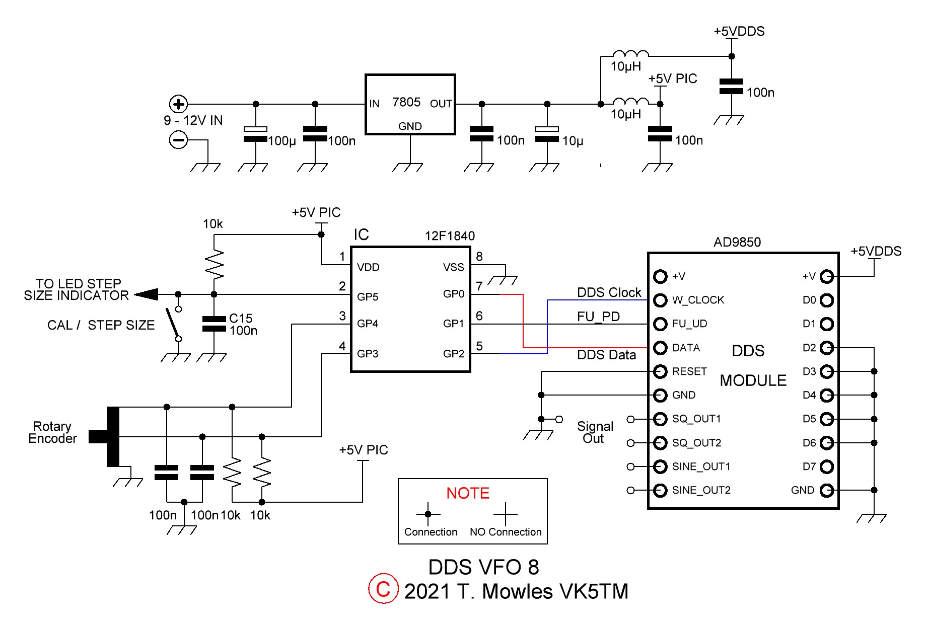

Mike (Pommie), has kindly offered to try and teach me to program microcontrollers in C, hence this thread.
Hopefully it may also help others on this journey.
Because I learn better by doing rather than reading and trying some inane example, we are going down the journey of converting one of my asm projects from my website - the Simple VFO project.
For the compiler, we are using MPlabX 5.45, XC8 and a 12F1840 PIC.
So here are both the schematic of the project and the current asm code (12F629 version - this code version is not on my website yet).

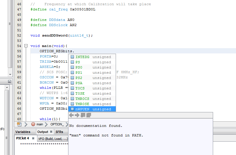

OK, before we get any further, where did this come from - nWPUEN - I know it is the pull-up disable, but where did the 'n' on the front come from?
It's one of microchips defines (not weak pullup enable) and to find what bits are contained in a register, type OPTION_REGbits. and a list will appear, like this,
Once you know what the bit is called you can just use the bit name. I.E. nWPUEN = 1.

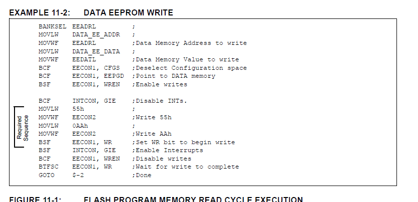

As you use EEPROM in your code, at some time we'll need functions to write it.
The datasheet gives this example,
To convert this we make a function, We'll call it readEEPROM and we'll give it two bytes of data, the address and the data.
We use, void readEEPROM(unsigned char address,unsigned char data) - void means nothing is returned and unsigned char is a byte variable (address and data).
We can now almost convert the above code action (not line) by action.
The first three lines will convert to EEADRL=address;
The second two to EEDATL=data;
The final code will look like,
void writeEEPROM(unsigned char address,unsigned char data){
    EEADRL = address;
    EEDATL=data;
    CFGS=0;
    EEPGD=0;
    WREN=1;
    EECON2=0x55;
    EECON2=0xAA;
    WR=1;
    WREN=0;
    while(WR==1);
As I've placed this code at the end of the code I need to add a prototype to the top.
The top of the code now looks like,
#define cal_freq 0x00501BD0L
#define DDSdata AN0
#define DDSclock AN2
void sendDDSword(int);
void writeEEPROM(unsigned char,unsigned char);
void main(void){

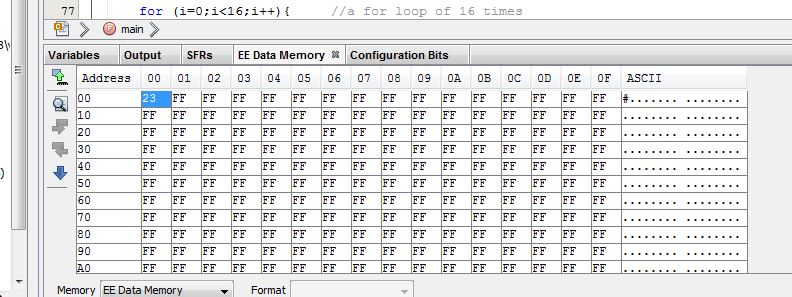

To test the function I added a call to it just before the while(1),
    WPUA = 0x00;
    writeEEPROM(0,0x23);
    while(1){
I can compile this and it will run. I can then stop the debugger (pickit4 in my case) and read the contents of the chip.
I then select the EE data memory tab and see,
And I know that it's working.
You can try this for yourself.
