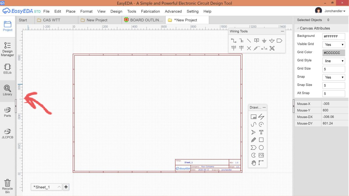

Regarding finding the right components and footprints, the library of parts in EasyEDA is huge. For common parts, there is little chance you have to "edit" anything. About those tutorials.....
To find symbols and foot prints, search the iibrary.

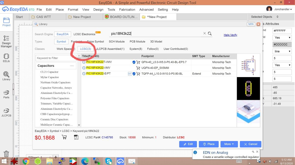

Fill in the part # you're looking for and click the magnifying glass. Since you're not having this part assembled by JLC, select LCSC as the source.
Select the appropriate package and plop it on your schematic.

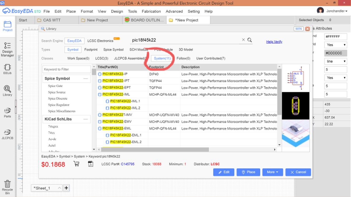

If searching on 18F43k22 doesn't return the right package, you can expand your search. Remember, the '43, '44, '45 and '46 versions are the same chip, with different amounts of memory, so searching on a different version may yield more results. Also, selecting SYSTEM instead of LCSC. This adds "user contributed" parts to the search. Use caution with user contributed parts and verify accuracy of the symbol and footprint.
Finally, if all else fails, symbols and footprints can be imported in a number of formats. Digikey and Mouser provide these for many components. You can download a file, use the provided tool to create the symbol and footprint in Eagle format for example, and import it in to EasyEDA. This is at most a five minute process, but way beyond what I have the patience to explain here.

If you LOOK AT the second picture I posted, the 3rd item is a PIC18F43K22 in a TQFP package. Click on that part and drop the part on your schematic. When you lay out the circuit board, the correct package will appear.

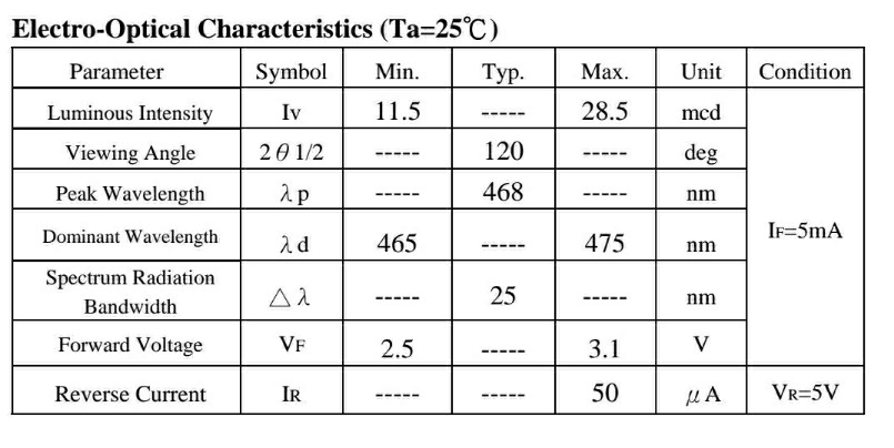

Regarding LEDs in series, I don't know what research you need to do. Here is an excerpt from the datasheet for JLC's basic blue LED.
Of interest is the line labeled FORWARD VOLTAGE. It varies from a minimum of 2.5 volts to a maximum of 3.1 volts. Don't misunderstand the meaning of this. Some of this type of LEDs may have a Vf as low as 2.5 volts. B]Some[/b] of the LEDs may require as much as 3.1 volts to laminate. Most of the LEDs will turn on in the middle of that range, say 2.7v – 2.8v. But you need to allow for a batch of LEDs that has Vf of 3.1 volts because the ones you might receive might all have a Vf of 3.1volts.
You can't put 2 LEDs requiring 3.1v each and expect them to operate on 5 volts.
The green and white LEDs have a maximum Vf of 3.7 volts. Even worse.
The forward voltage is based on the chemistry of the LED. Blue LEDs from any manufacturer will have very similar Vf parameters.
