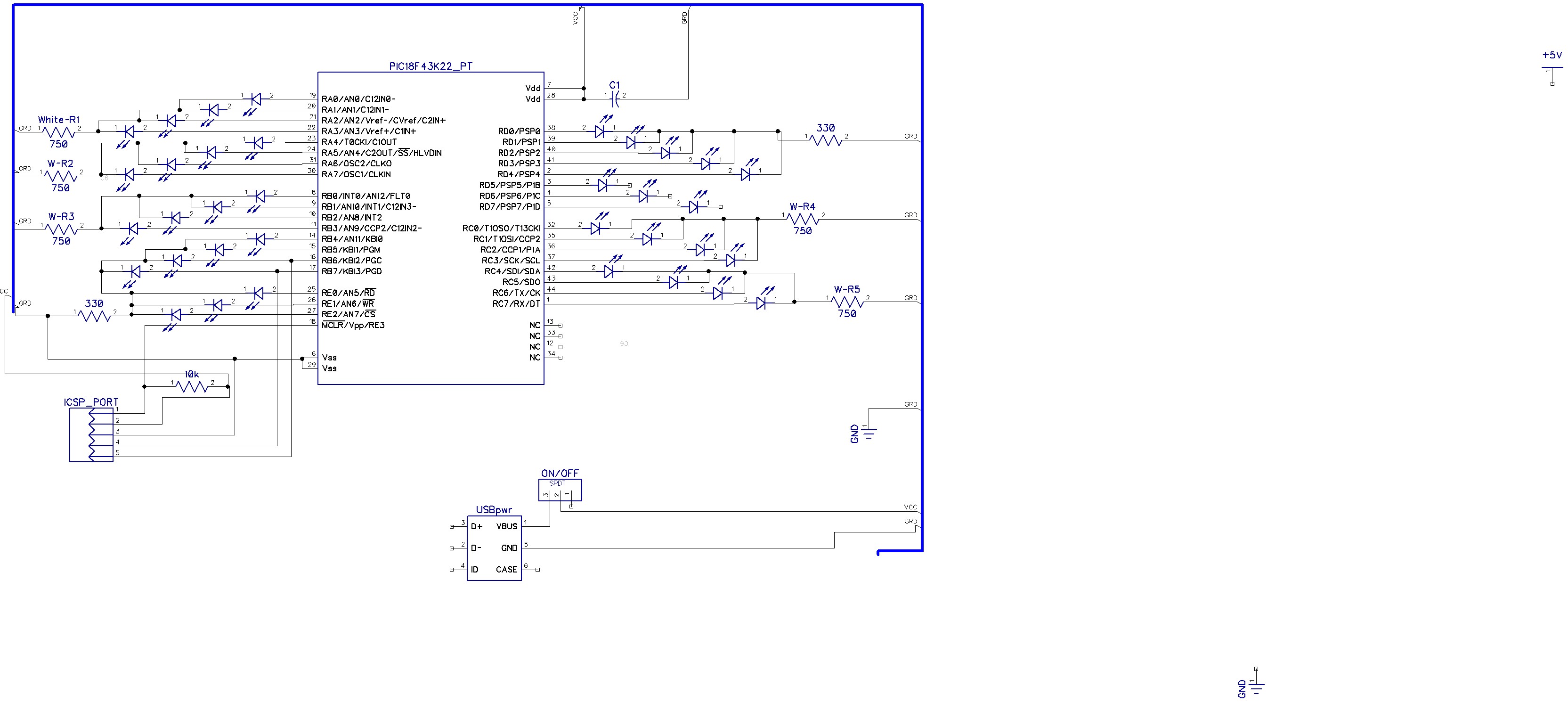

I haven't given up on the LDR, the remote idea came about on if the Star can be turned on and off remotely IF the Star is on top of the tree thus making remote control an option but it is fading fast.
My goal on this project is KISS
Keep It Simple Stupid
1-low cost
2-low battery consummation if battery only
3-keep weight of finished project low (in case it is installed on tree limb, thus coin cell batteries)
4-remote control would be nice to change the pattern of the LEDs if tree top only

Be aware that (Vishay) TSOP1738 requires 4.5 Volt to 5.5 Volt supply and typically 0.6mA. Two CR2032 coin cells might last only 2 weeks even if the rest of the circuitry uses no current.

sounds like the TSOP1738 IS NOT A VIABLE OPTION due to current consumption if only using battery power.
The idea of the USB wall wart devices looks better, just need cables.
Do you realise that just one 20mA LED will flatten two button cells in about 20 hours.

Not to enter the fray, but the TSOP draws 6mA. Still, a handful of LEDs is going to be a lot already for a CR2032.
Been rethinking my goal and cost of finished project.
Decided to eliminate the IF detector and battery. Cost of battery + cost of holder etc is about the same if I include a wal-wart/usb.
The scenario I want to avoid is the phrase "batteries not included" The USB cable fits under this definition in my book.
Found a pack of 5 USB AC ADAPTER PLUGS W/ 6 FT USB CORD for $22.98 at Amazon. And they say UL approved. I want the person receiving the gift to be able to use out of the box.
as far as too many LEDs I plan to multiplex so the twinkle (yes have done same last year)
