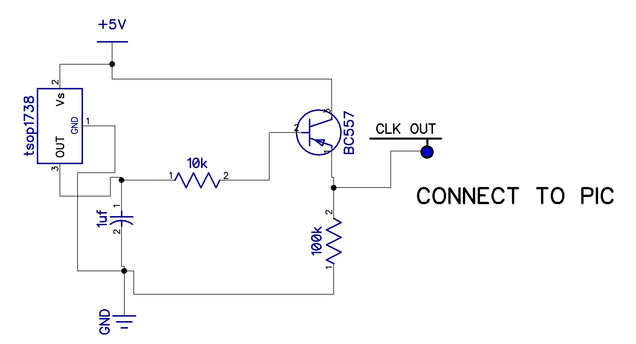

Did some research and found a viable cheap method for remote control of Christmas star. Maybe program pic to change pattern with remote.
Why the transistor at all?, and why is it upside down? - also what's the 1uF for?.
Are you trying to detect 'any' IR signal, or actually read the signal in the PIC?.
It's also usually a good idea to decouple the supply to the TSOP, check my tutorial hardware.
yes I located a schematic that does not use a transistor.

yes it is maybe in need of a cd4017?

was thinking of bread-boarding and using a tactile switch to emulate the TSOP 1738 input?
The capacitor is supposed to suppress the 38khz signal? as per reading about the circuit I posted.
The 38KHz signal doesn't come out of the TSOP, which demodulates it and only provides the original modulation (or a rough approximation of it).
As you're feeding a PIC pin, why not just decode the modulation?, it will be MUCH more reliable, and then you can select different options using different keys.
