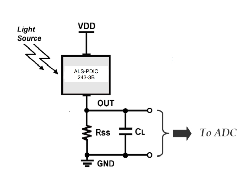

working on Christmas 2020 project and trying to decide what to use for detecting "dark'"
project entails a Christmas star that is placed on top of Christmas tree, powered by coin cell battery or 5v USB walwart.
leaning towards the wall-wart idea so battery would no need to be replaced.
project utilizes an 18f43k22 to control the 35 LEDs.
the light sensor will turn on the LEDs when it gets dark and runs for predetermined amount of time ( thinking 6 hours) thus a long delay is programmed in the pic.
the light sensing circuitry to be connect to an ADC port.
looking at different light sensor ideas using photo diode, photo transistor or even an LDR. All basically the same but trying to utilize the KISS method.
any ideas on which sensor type to utilize?

You might consider something like the Everlight ALS-PDIC243-3B (datasheet). It will have more uniform and predictable results than random photocell, and its response to tailored to match the human eye – IR is filtered out.
At LCSC, the qty 10 price is 20 cents each, or 42 cents each at Mouser.
The circuit is pretty simple.

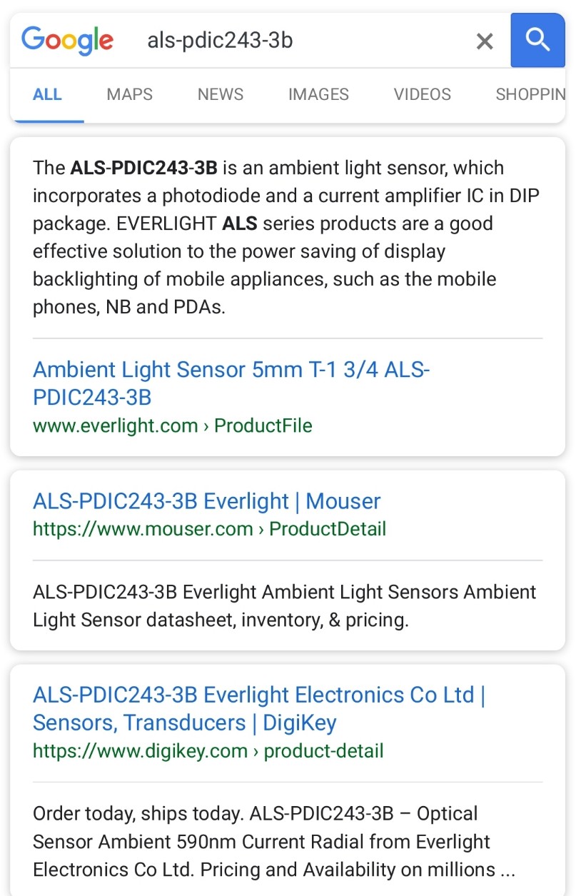

I clicked on the data sheet that Jon posted but it is a relay, not a LDR
it happens
Sorry. Link fixed. But to be fair, the part number was there – you could have found it with the tiniest bit of effort.
I was wrong in thinking you posted the correct link.

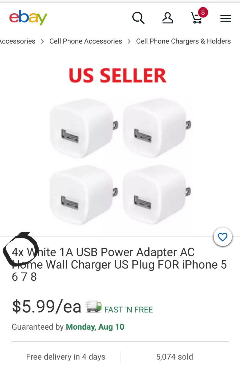

been searching for inexpensive wall warts but everything is $6+
These Christmas stars are Christmas presents for friends and family so cost is a big issue. Need to $hip these stars to Florida and California so my cost has exploded not to mention if going with a wal wart then a voltage regulator will be needed so cost = ++
Going with battery power only with LDR

Any USB wall wart will power a USB Arduino which will easily make your project possible.
First ebay listing. USB charger, 6 bucks. For 4. With free shipping in the US. That makes them $1.50 each. You should be able to find USB cables cheap. A full-size USB-B connector on the board will be easy to install and will take a beating and survive. Or cut the connector off and solder wires directly to the board.
Sounds like you didn't even take a look at the datasheet after I corrected the link.

Seems like a good deal but, do you really think they are CE/UL listed? What is the flammability rating on that housing? How hot does it get?
I stopped buying those 4 for $x deals because I don't really want to burn someone's house down to save a buck. And, I don't send non-idiot proof devices for friends and family because I don't want them to burn their houses down even if the power supply is UL listed - especially putting something atop of a terpene-filled, dried out evergreen.
You're right. Usually, I buy better power supplies. For about the same price.
At thrift stores and PC recyclers, one of the greatest values are power supplies from cell phone and computer manufactures and other "wall warts" that came with consumer electronics. These power supplies were engineered for a long service life, follow good design practices and have all the ratings. For a buck or two. Some are a little more, like the mammoth X-Box power supplies, which provide 12 volts at up to 16 amps depending on the version.
While I can't state with utter confidence as some do here, the switching power supplies I have tested have a strong self-preservation instinct. As current draw approaches the and exceeds the maximum rated current draw, the output voltage rapidly falls to zero.
