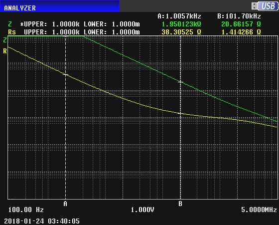

You should expect the ESR for an older disc type ceramic cap to be high at low frequencies. Here is an image showing the ESR and impedance magnitude at frequencies from 100 Hz to 5 MHz of a 100 nF ceramic disc cap. The impedance is shown in green and ESR in yellow. Note that the scales are logarithmic.
The ESR at 100 Hz is 385Ω, at 1 kHz it's 38Ω, at 10 kHz it's 5 ohms and at 100 kHz it's 1.4Ω
Be aware that the ESR of capacitors of various types typically vary with frequency, sometimes by orders of magnitude. There's nothing wrong with your meter.

The reason Elerion got a high value for ESR at low frequencies is because those old leaded disc capacitors actually have a high ESR at low frequencies. I showed this with the impedance analyzer sweep in post #12. You should get the same result with a bridge. His meter can discern between ESR and capacitive reactance.
