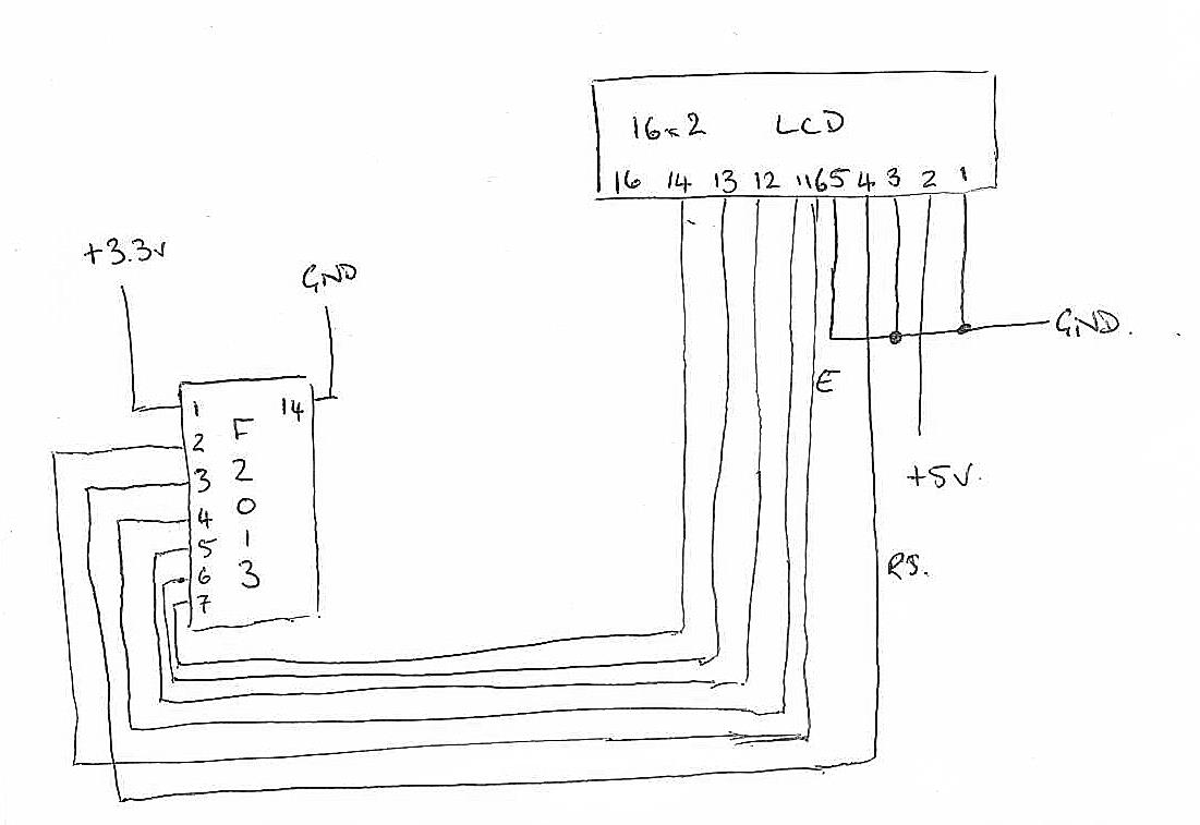

Hi to anyone still reading what I have to say... Once again one more question.
I have wired up the LCD and it does appear to power up with my 7805 circuit, however it does not seem to want to accept logic inputs from the F2013.
So to ask the experts...
1. Does a 5v LCD need 5v data lines?
2. Should I put some pull down resistors on the outputs? Would this help?
Thanks, its frustrating me a little now!
PS. I dont have a datasheet, but it runs off the HD44780 chipset.
Have you got the contrast voltage set for the lcd? If its set too high it would give the symptom of being dead..
I found the first time I used an lcd, I thought it was dead...Turned out that the contrast voltage needs to be turned rifgt down to zero volts almost...in fact even a negative voltage might have helped.
LCD contrast is correct I think, when the LCD turns on it shows one line light and the other dark, I'm assuming this is some sort of startup test? As I mentioned before, I'm sure its powered up ok... just wont take data and give me a blinking cursor!
Ive tried manually setting DB0 - DB4 at 5v and clocking E, no result
I have also tried with microcontroller doing DB5, E, 0, E, 0, E, DB4-DB7, E. ( I think this is the same as above but 4bit mode?)
Hi, thanks for the reply.
R/W is grounded, I assumed a problem with the uc, so tried to connect DB0-DB3 to +5v, then touch +5v to the E, but no response. Is this normal also? Tried looking on the internet for stuff like this, but all info assumes that you can get them running ok!

The basic code follows.. just to try and get the lcd initialized!

The circuit should explain itself from how the code is written, but it is attached anyway.

Some notes:
1) There is no way for me to see how P1 is connected to the LCD (which bits are mapped to which data lines). According to your code, the MSb (bit 7) is connected to DB7, bit 6 to DB6 and so forth. If this is not the case you are not connected properly. To verify, break after: P1OUT |= DB5; and test the data lines. The correct values should be: DB7: 0 DB6: 0 DB5: 1 DB4: 0
2) I don't know if your startup sequence is wrong, but it's different than mine. Try to following:
// initial function set
DB7 : DB4 = 0010
Pulse Enable
Wait 50ms
// resend function set w/params (5x7 font, 2 lines)
DB7 : DB4 = 0010
Pulse Enable
DB7 : DB4 = 1000
Pulse Enable
Wait 2ms
// blink cursor, display on
DB7 : DB4 = 0000
Pulse Enable
DB7 : DB4 = 1111
Pulse Enable
Wait 2ms
At this point you should see a blinking cursor. Check my drivers page for an HD44780 driver which should show you how to continue the initialization (not much further).
3) Your contrast pin (3) is grounded. This will set the contrast to 0 and you will see nothing. Connect this to a variable resistor.
4) I think the enable pulse has a max value. Check the data sheet and see that you are within spec. I pulse it for about ~5uS i think.
