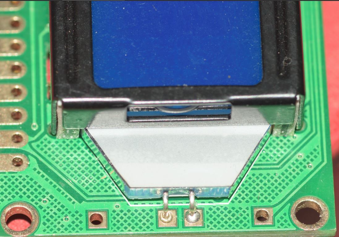

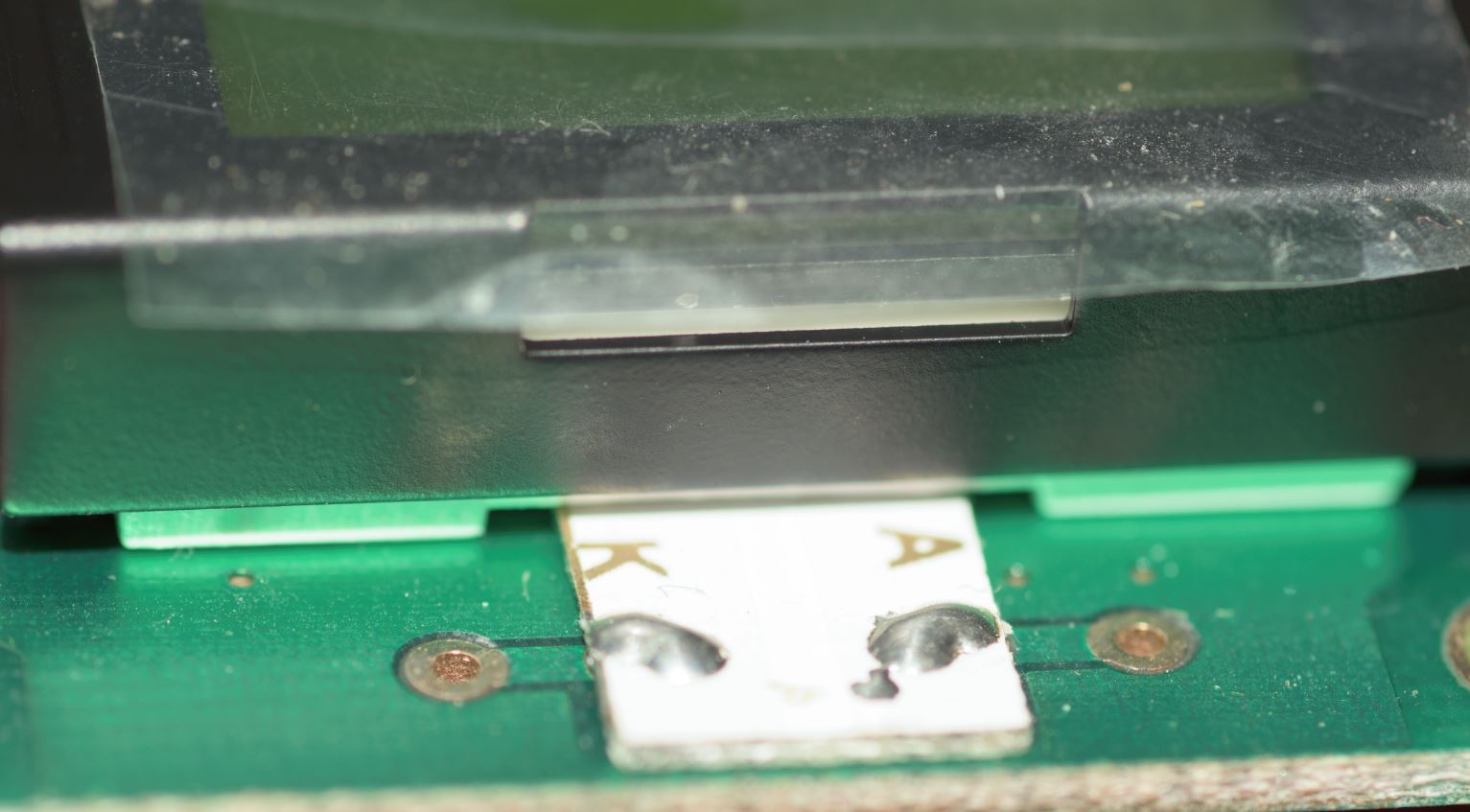

Ok I am right and wrong at the same time!
two pics.
This is a 40 character 4 line LCD and has a LED backlight as you can see, it goes right under the unit. the next pick is a 16x2 lcd and show a different LED unit that also light the back, but this is the led unit I have taken off and shone through the glass bulge bit on another unit. I have one of the same LCD's you have and one I have modified with a different LED, both are in the draw in my dads workshop........... I tried to go get them tonight to photograph but didnt make it inside (sorry) I will do it tomorrow, I just couldnt open the door tonight but tomorrow I will be ready

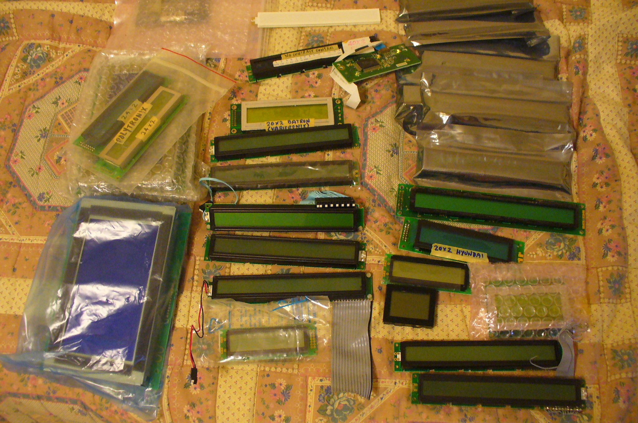

OK.
Am attaching a picture of what I have, note several are in their antistatic bags. Center top (white) is a backlight that slides under the LCD. Color is likely green, and I have more of those 'backlight only' but just moved and my stuff is boxed and my brain is not functioning right with so much to do and remembering what is where.
I could send several for you to try, keep what you need. My workbench is non-existant right now in order to find which is what.
Added: The rear glass has a silver film for reflective type displays, and no film for the ones fitted with the backlight 'bar' under it.
The backlight 'bars' are 5 3/4" long x 3/4" wide and 1/8" thick, with +,- solder pads.
Found the controllers have a vendor sticker on top; but likely Hitachi 44780

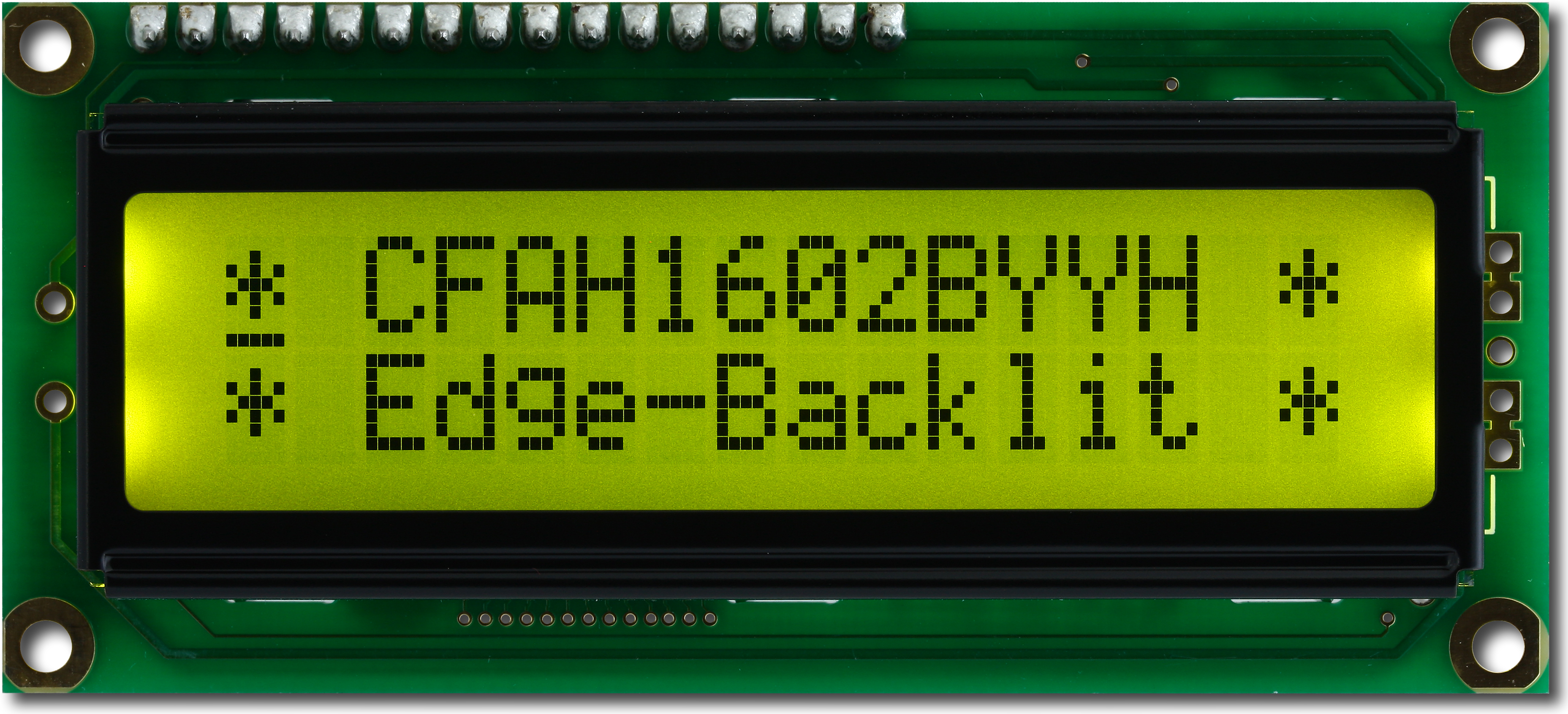

Or edge lit :
----> http://www.crystalfontz.com/phpthum...ducts/CFAH1602BYYHJTE/CFAH1602BYYHE_large.jpg
