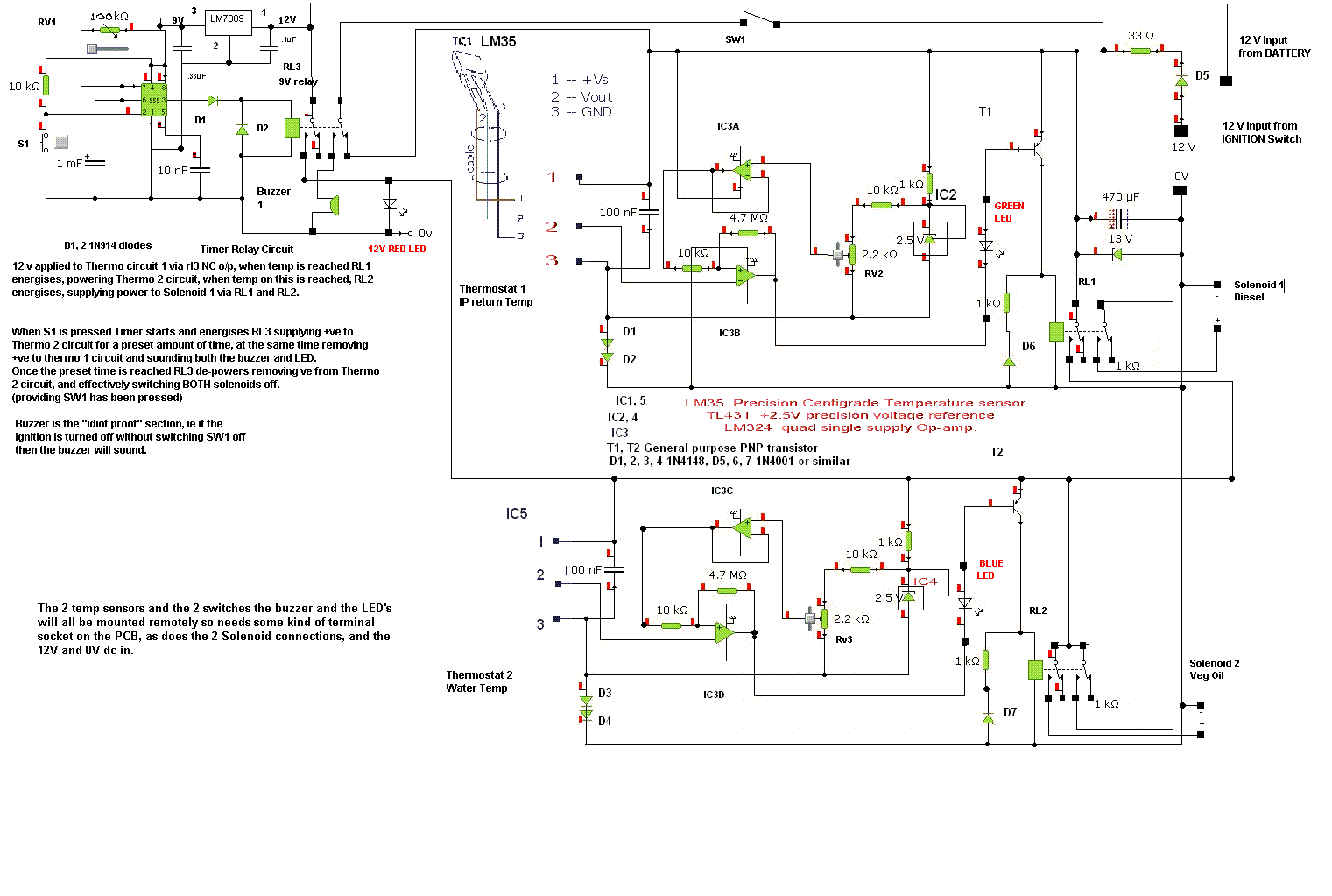

Has anyone got any circuits for an LCD display that DOESN'T need a pic or similar to program it?
What i want ideally is a 1 line LCD display that will display one of 3 WORDS, that are preset.
It only has to display 3 words, one being DIESEL, the others being VEG OIL and PURGE, 1 at a time which one depending on which is selected by a switch or similar
IF it helps, I've attached a circuit diagram of what it will be connected to, basically when solenoid 1 and 2 are on together, it would read "VEG OIL", when both solenoids are off it would read DIESEL, and when S1 is pressed ( only solenoid 2 is active) it would read "PURGE"
ANY ideas welcome, or any other suggestions

Already have indicator lights on the circuit, but I was hoping to make it easier to see and less confusing if anyone else was driving the car hence the LCD idea
Low tech indicator lights are still used as they are generally much easier to read than an LCD display. Color also helps convey information.

The most elegant solution is a microcontroller like a PIC connected to your LCD. Then you could dump the 555 timer and most of the other circuitry also....
As mentioned, you could use large indicator lights with the words DIESEL etc engraved on the bezel.

To do what you need with a PIC will only take 30 or so lines of Proton Picbasic..
I just lashed up some quick and dirty (aka untested!!) code to show how simple it really is!!! :D

Is it possible to program a PIC to measure two temperatures via some sort of probe? and once a preset temp has been reached (possibly by setting an LM35dz circuit?) activate a circuit (or two) that would then operate relays? and display on the LCD display one of a number of messages depending on which output was active, while say the 2nd line of the display would display a 3rd temperature (to be measured also)
Yes, a pic can do all of that and more. Do you have a link to a description of what the circuit does?
If you refer to my first post it has a gif of a circuit that i did.
The basics of the circuit was taken from this page http://www.escol.com.my/Projects/Project-03(Thermostat-1)/Proj-03.html
which is basically a thermostat, that once the temp probe (lm35) has reached the preset temp it trips a relay.
My circuit follows on from that one, and using on using a single LM324 comparator instead of the original LM358, 2 complete temperature sensor circuits and a timer circuit based on a 555 chip that once activated latches a relay for a set period of time (ideally 65 seconds)
To do the design using a PIC, IF its possible i'd like as much done in the PIC itself and as few external components as possible.
I've decided on a 2 line display OR if its possible to make it work "this" **broken link removed**
What I'm hoping for in the end, is to have a device that will measure 2 temperatures (water and diesel) in my car, and once the water temp is 75ºC AND the diesel temp is 50ºC 2 relays will operate 2 relays in various configurations, and a timer/buzzer circuit depending on the values of the LM35DZ's
Most of what you need is on the site of a member here . The spare pins on the pic in the diagram can be connected to switches, relays or more LM35s.
As for the LCD, some time ago I did a demo using such a display - clicky. The advert doesn't state which controller chip it uses but going by the price I'd guess it is the KS0108.
