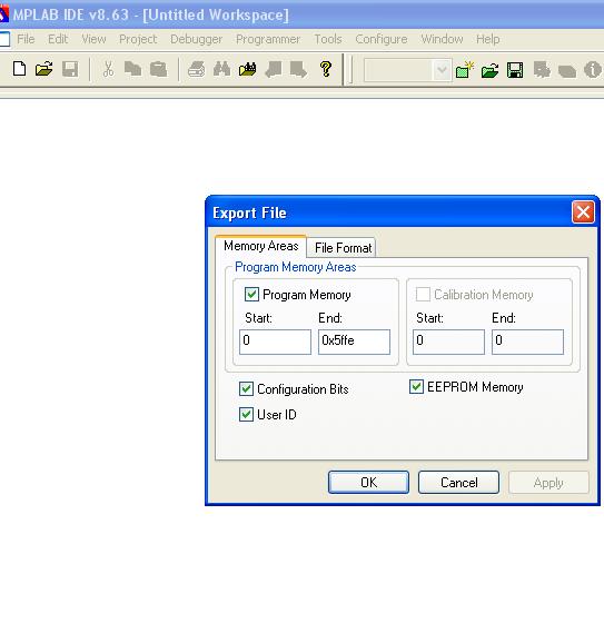

in read device..my lcd display is blank only....may i know why?? im using hitech compiler...can i use pickit2 to load my hex file??
after i had imported my hex file...it come out a warning sign state as " some configuratiomn words not in hex file. ensure default values above right are acceptable"
