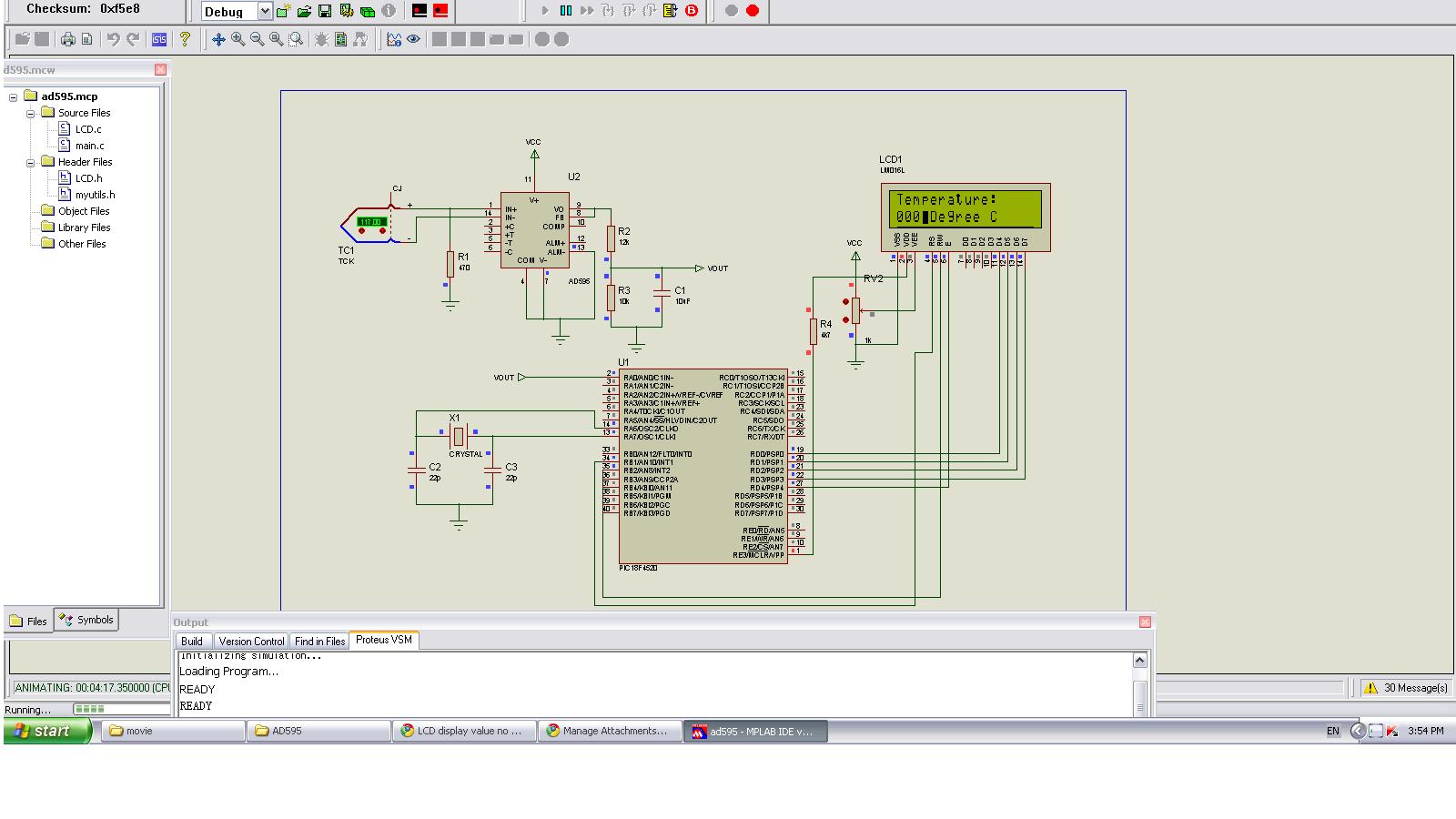

im newbie in programming.....im using MPlab and HI tech compiler to simulate my project.....
i would like to create a temperature measurement device by using thermocouple....
the problem is my lcd display no response (stay at 000) even i have changing my thermocouple value....
HOpe that anyone here can help me to figure out what happened..appreciated it!!
here is my coding.......

ohhhh......im using PIC18f4520....with this chip i need to set like what u have mention??? really appreciated ur helps.....
hi be80be....
i have been try what u have shown me as above....but my display still the same..what can i try nexT?? OR here i attach my schematic.....can u help me to figure out is there any mistake??

re-post your code so we can see what you did
ADCON1=0b00001110 this is what you need. Not ADCON1=0b00001101

Ohh ya...sorry for asking how to set the voltage reference configuration bit VCFG0, VCFG1 ???

ya i know bit 5 is VCFG1 and bit 4 for VCFG0 ....but the problem is i dunno how to write it??sorry im noob....
izzit u mean set ADCON1 = 0b00101110??
Bit 7 = 0
bit 6 = 0
bit 5 = 0 for VSS 1 VREF-(AN2)
bit 4 = 0 for VDD 1 VREF+(AN3)
bit 3 = 1 \
bit 2 = 1 \
bit 1 = 1 / these set the pin you want to use
bit 0 = 0 /
ADCON1 = 0b00001110
Just like this

this is all my code now.....any mistake??but still the same my display stay at 000 .....what mistake i might make???
There a lot of junk in your code Your hardware is setup like in post #4 ?
You need to setup adc take a reading and send that to your LCD
Something like this

thankz for ur code.....but now my display is empty ..
no "000" anymore.....js left the temperature and degree C only.....

ohh.....then what i have to add on???btw my schematic connection got affect???
Zip up you whole MPLAB project file all of them and post them and I help you get this going

ohh....im new in pragramming so i not really know to figure the mistake i had make.......but i hope u guys can lend me ur hand......appreciated it much i need ur helps....
btw what can i do next?? im using HI tech PRO V9.65......
be80be...
how is my coding???can it been solved??or what can i add on or what can i learn to correct the configure and match the module????
